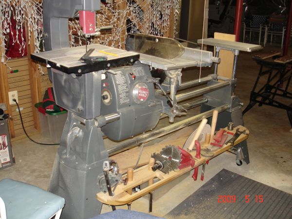

My wife and I just picked up this Mk V, with bandsaw, biscuit jointer, router and a bunch of other misc accessories.
I've been trying to talk my Father-in-Law out of his early '80s Shopsmith for about 13 years, I finally gave up and bought a 1992 model off of Craigslist this am.
Now for the projects...
- shopsmith.jpg (58.91 KiB) Viewed 3010 times
Welcome to the forum woodshopflunky. Looks like a good one ya got there. Are ya missing the tail stock and the lower saw guard? Ya might want to do some reading here.

I think the bottom guard is missing. I just set it up for table saw and noticed 10" of spinning saw blade just hanging out under the table. It was $900, a good deal I think, a Mk VII is like $3,600+
