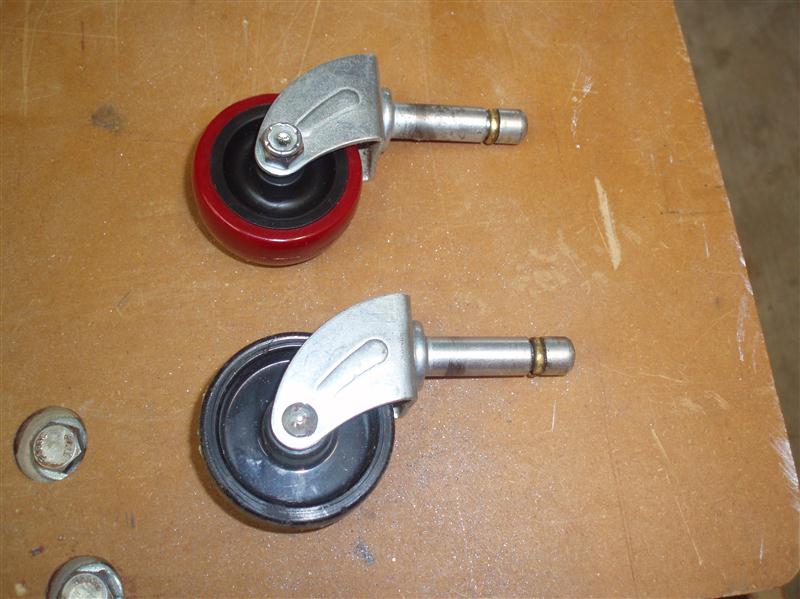

Does anyone out there have the newer 2" casters. What Shopsmith is offering as a replacement caster appears to be a small version of the new 3" caster. This wheel assembly appears to be a bit heftier than the originals.
This picture shows the wheel assembly that I currently have and it also shows the original wheel along with the new wheel type that I put on my Pro Planer (heavier SPT).

dusty wrote:Does anyone out there have the newer 2" casters. What Shopsmith is offering as a replacement caster appears to be a small version of the new 3" caster. This wheel assembly appears to be a bit heftier than the originals.
[ATTACH]17726[/ATTACH]
Dusty,
I have the newer gray 2" SS wheels on my MK V PowerPro and my Power Stand. Wheels roll way better than the old black plastics ones.

I bought some 2" from menards that work well.

I also have Menard's casters on 2 of my machines & they're a great improvement. About $4 each. Ball bearing swivel. I mentioned them in an earlier post that took on a life of it's own & analyzed the crap out of a simple, cheap, great, readily available concept. The bottom line is: they're all of the above.
