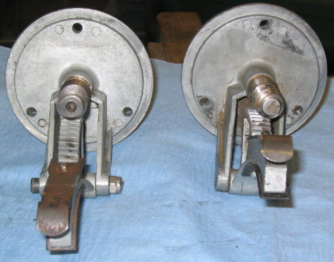

db5
Posts: 1192
Location: Oklahoma City
Post by db5 »
fgrule wrote:It corrects the bent arms, so common on the porkchops, that make the speed control difficult to turn. It's basically a bolt that prevents the arms from bending again once they are bent back into their correct position.
Fred
Okay, inquiring minds want to know. What the hell is a "pork chop". Everyone talks about it but I don't have a clue even though I have owned a Brownie, a MK Vii and now a 510. Please post a picture so I know what this is?
billmayo
Posts: 2342
Location: Plant City, FL
Post by billmayo »
db5 wrote:Okay, inquiring minds want to know. What the hell is a "pork chop". Everyone talks about it but I don't have a clue even though I have owned a Brownie, a MK Vii and now a 510. Please post a picture so I know what this is?
The "pork chop" is the quadrant. It is the lever with the teeth and flat spring. The left speed control has the bolt, washers (later added) and nut. The right shows how the a bent leg allows the worm gear to wear on the side of the quadrant teeth.
