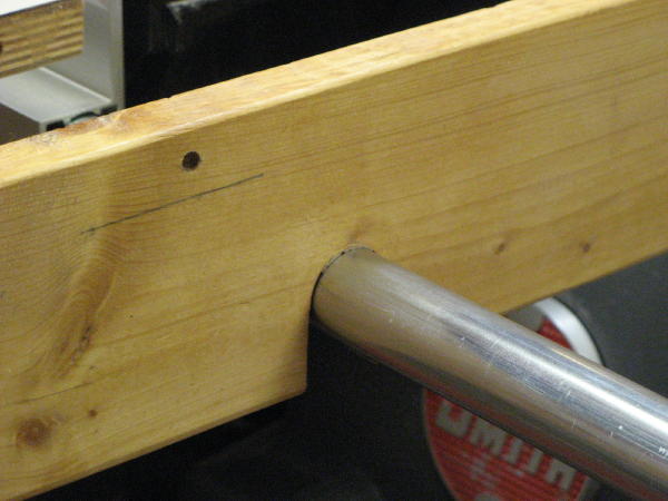

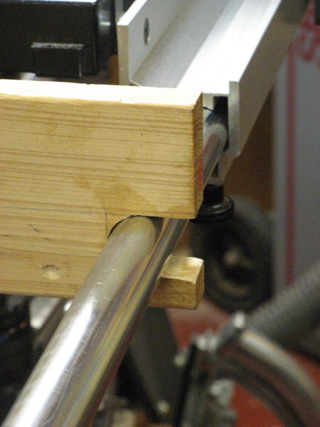

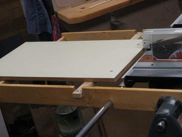

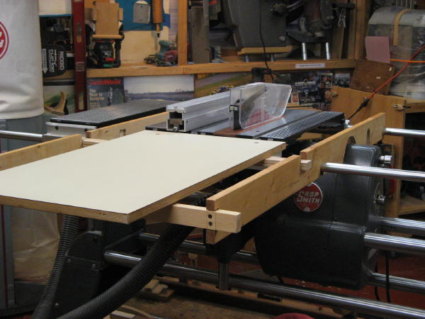

I wanted an outfeed table that was cheap, easy to make, easy to put on & take off, and would adjust when the table was raised or lowered. It's cantilevered from the connecting tubes. It works with the long or short tubes. I can add or remove it in under a minute. Works fine for bevel cuts as too.
I cut all the notches on a 2 x 4 then ripped it into two pieces with the band saw and attached the cross members. The table itself is pw with Formica glued to it.
I have two sets of cross members. On one set the unit 'hugs' the main table. With the other set (shown) I have room to add a floating table on either side of the main table and slip the outfeed unit around it.
