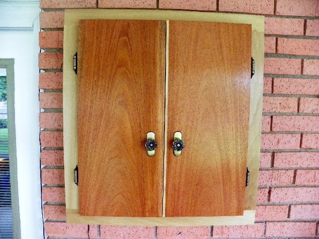

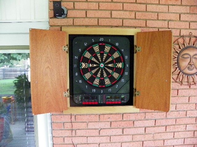

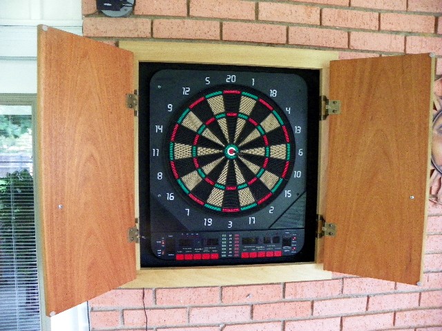

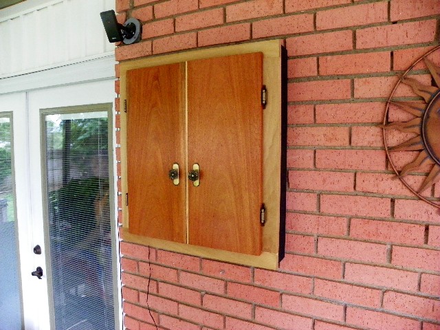

Here is my latest honey-do project. SHMBO picked up an electric dart board on one of her yard sale excursions and wanted me to build a cabinet for it to hang in our sun room. It's made of 1/2" MDF for the back, 3/4" ash for the frame and facing and I don't have a clue what the doors are made of. They are a couple of boards I rescued from a trash pile. If any of you have a guess I would really like to know what they are.
I sprayed the interior and outside of the box with flat black. The facing and doors are finished with 5 coats of wipe-on poly with a light once over with 0000 steel wool between coats. After the last coat dried I went over it with Johnson's Paste Wax applied with 0000 steel wool which gives it a super smooth, satin feel and look.
Thanks for looking and be sure to give your best guess as to what kind of wood the doors are.

I don't know what kind of wood it is, but it sure looks nice.

If not stained, based on wood grain and color my guess is mahogany.
Nice Dartboard cabinet.

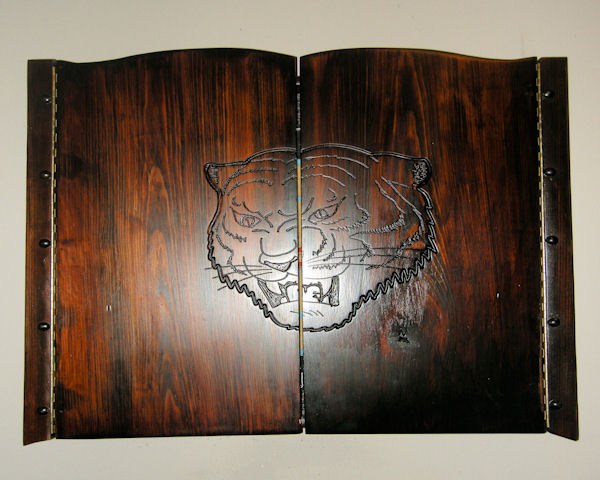

As I am an LSU fan mine has a tiger I routed on the front.

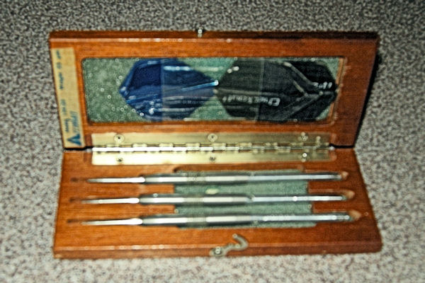

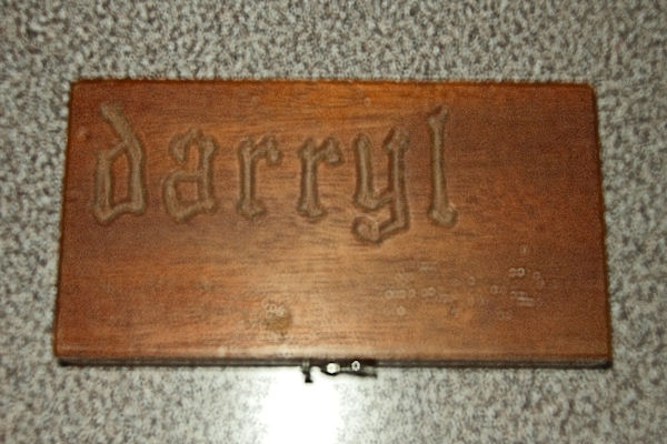

From a long time ago!
