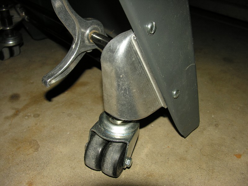

I put a set of dual casters on my 520 that I use here in Phx. this past weekend and found that I needed to elongate the mounting holes in the legs by only 1/8" on this unit. I used a dremel 3.1 x 6.3mm Cylinder HSS Cutter, 3/32 inch shank to elongate the holes. Moves over the cracks in my shop floor much easier. Added a pic for what it's worth.
ldh
ldh wrote: Moves over the cracks in my shop floor much easier. Added a pic for what it's worth.
ldh
It is worth a lot to anyone with cracks in the floor. Good Idea!!
