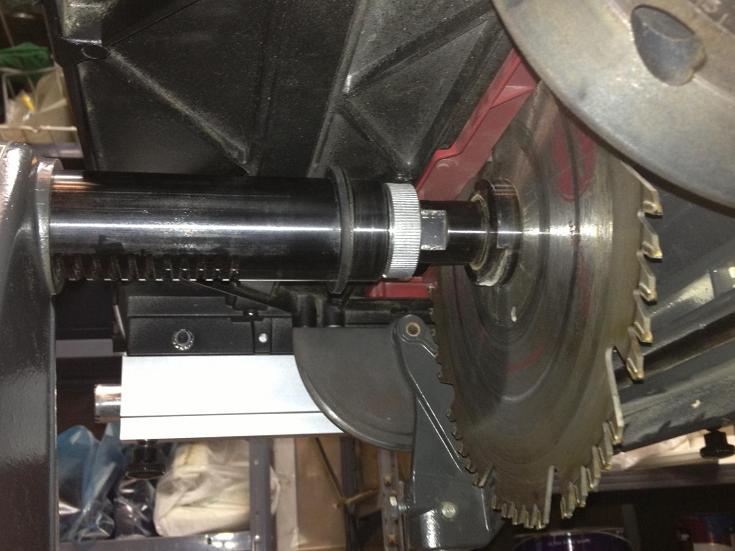

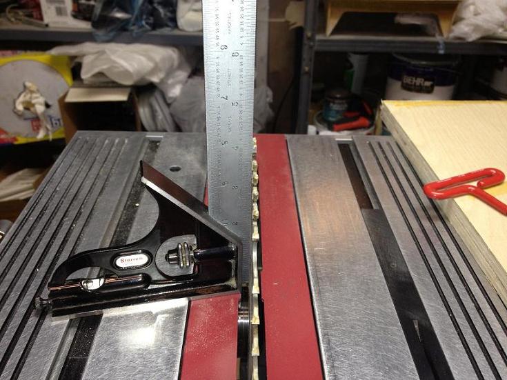

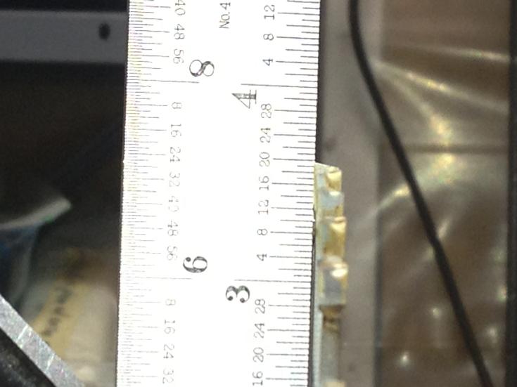

After testing this out, you can get slightly more than 3.5 inches depth of cut on a 520 with the blade through the table insert; however you must remove the lower blade guard and extend the quill. This allows the 520 table to clear the headstock. However, the lower blade guard (specifically the part that pops up on the springs) still prevents the table from dropping more than 3.25. With the lower blade guard removed, I get 3 and 20/32nds blade height; any more and the table is interfered with by the quill.
Here are the photos:
Showing my square next to the blade (parallax makes it look like 4 inches; see the next photo):
[ATTACH]18771[/ATTACH]
Up close and personal (no parallax):
[ATTACH]18772[/ATTACH]
From underneath:
[ATTACH]18773[/ATTACH]
