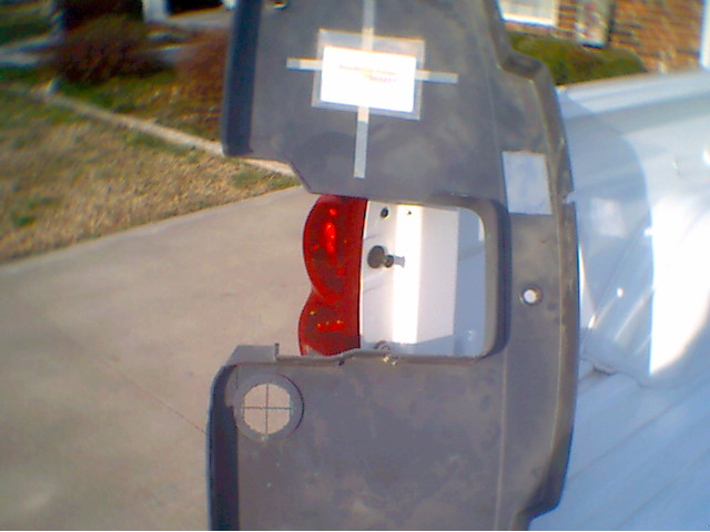

Here is what it looks like now. I used a scroll saw blade and hand cut out most of the grid leaving a cross section just for strength
- bandsaw dust port mod.jpg (60.71 KiB) Viewed 1891 times
