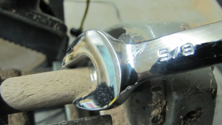

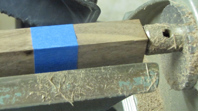

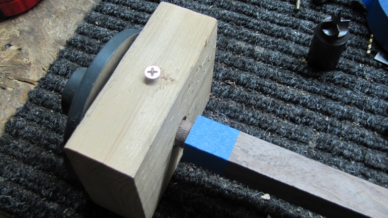

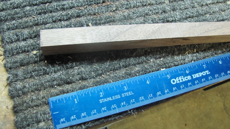

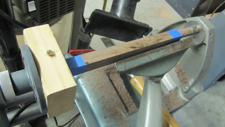

With some tips from each of you and little more thought, I documented the fix. Here is a few pics.
[ATTACH]19027[/ATTACH]
[ATTACH]19028[/ATTACH]
[ATTACH]19029[/ATTACH]
[ATTACH]19030[/ATTACH]
[ATTACH]19031[/ATTACH]
