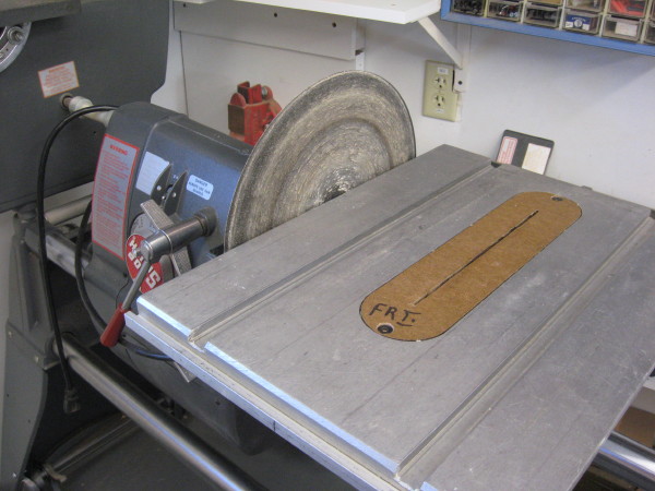

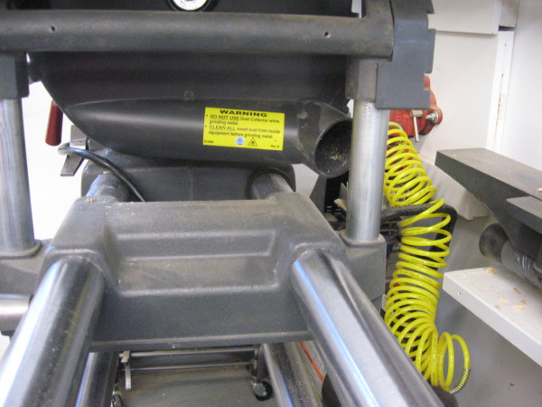

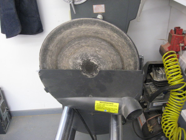

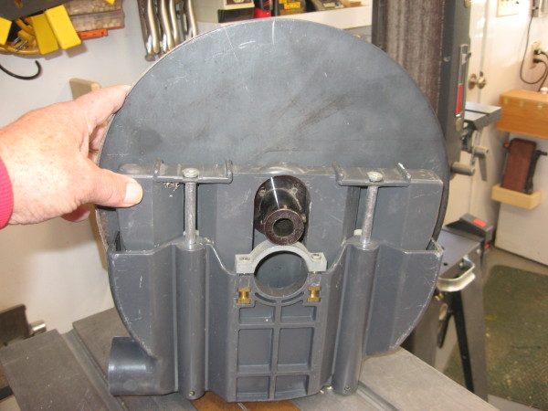

sanding disc and 500
Post by oldc6 »
The sanding disc will not fit into the 500 lower blade guard. A couple of years ago i bought the 510-520 lower guard to use with sanding disc.
Works great for dust collection but, can only be used on edge of table.
dust port of lower guard hits on table upright because 500 is narrower table.
I like using the edge of table because it gives you more table to keep workpiece flat to table. could be used in center of table with the 510 or520
see attached pictures[ATTACH]19184[/ATTACH]
[ATTACH]19185[/ATTACH]
[ATTACH]19186[/ATTACH]
[ATTACH]19187[/ATTACH]
