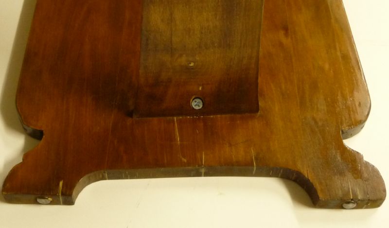

Warped Board Update with Pics

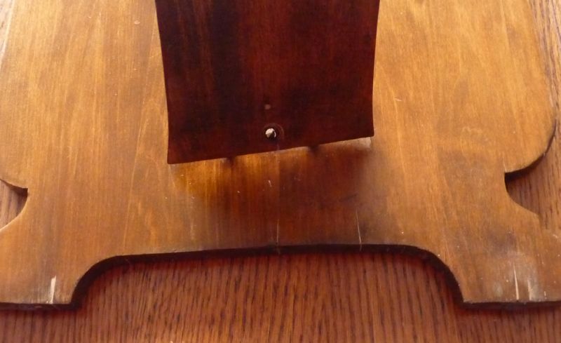

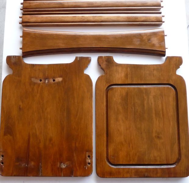

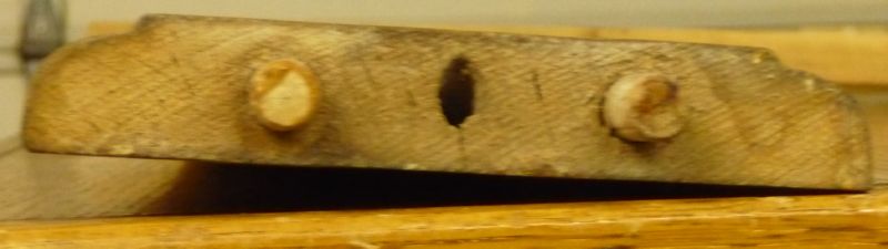

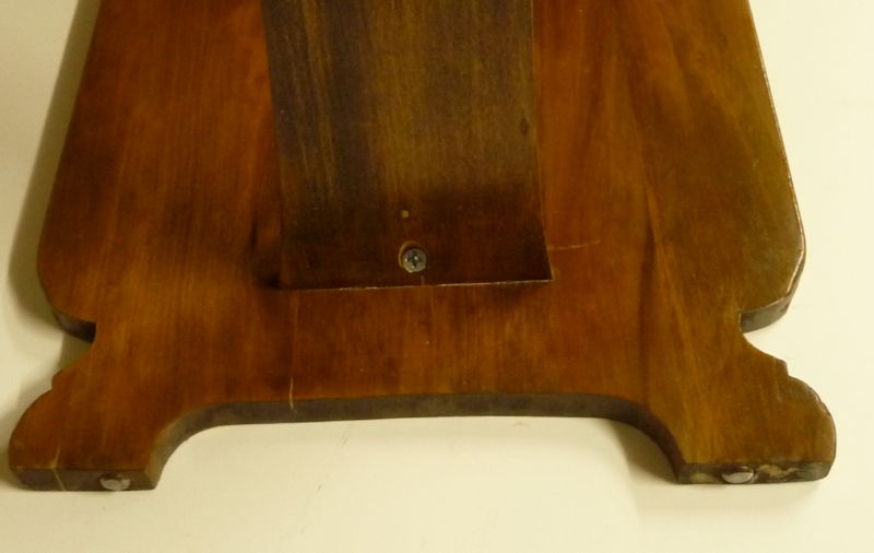

On the initial post I asked for recommendations on how to straighten a warped (70 year old) board and included a picture showing how much it was warped. JPG had the best recommendation, in my judgement. Here are the results of restoring this bench along with the original picture of the warped board.
The second pic shows the board as it would be if I cut off the dowels and just glued and screwed it to the end piece. Next are the pieces followed by the assembly showing the board attached to each end piece. Not PERFECT but if you weren't looking closely you would never notice.
Great solution JPG.
Great solution JPG.
