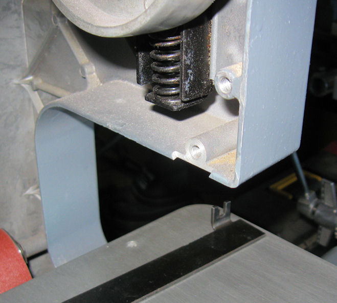

Troy
My strip sander does not have the upper platen attachment point machined either and my flat platen lines up perfectly.
[ATTACH]9840[/ATTACH]
I think it is supposed to be like that. Maybe simpler to modify the platen. Hope this helps.
upper platen attachment point.jpg (66.92 KiB) Viewed 1098 times
Peter
