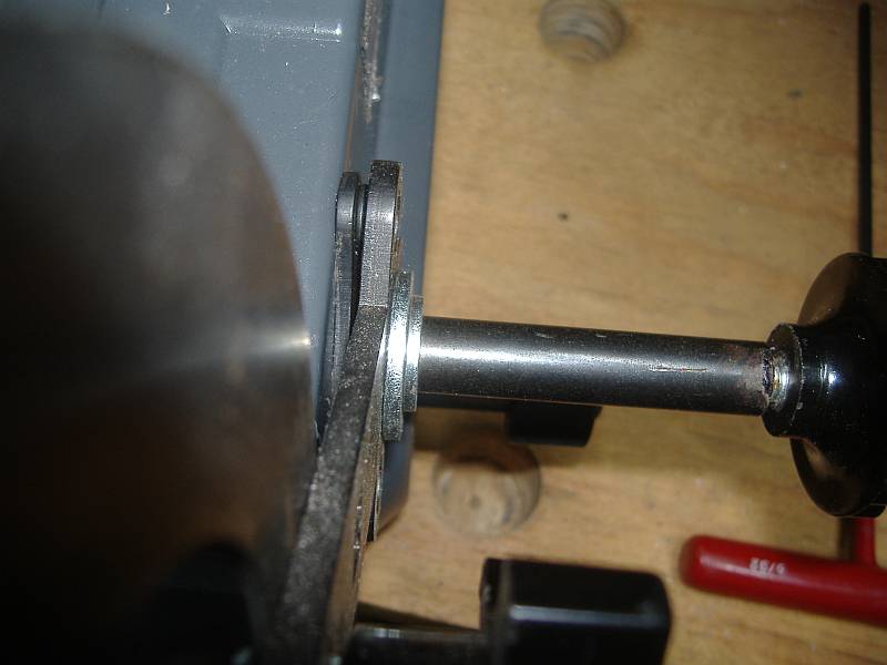

I have a strip sander (555309)(older one) which I use with the Chisel Sharping Attachment (555812). When I first put them together I noticed a slight misalignment of the "cup" holes and the center of the platen. I had to shift the holes to the left to get them center which I did by finding the right thickness washer in my collection and adding it between the support angle and the arm. While it works fine this way I have always wondered why the misalignment.

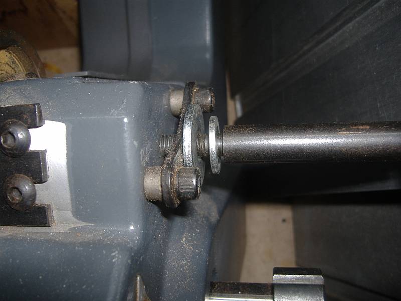

This is #1, note trunnion guide and spacers hardware.
[ATTACH]9153[/ATTACH]
#2 has no spacers and has button heads rather then socket head.
[ATTACH]9154[/ATTACH]

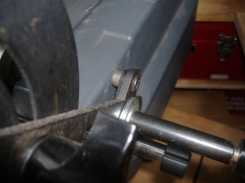

When #1 has the attachment added the spacing will be different left to right then when #2 has it mounted. First picture is #1 the second is #2.
[ATTACH]9155[/ATTACH]
[ATTACH]9156[/ATTACH]

My 121192 = #1. #2 does not fit the attachment well!

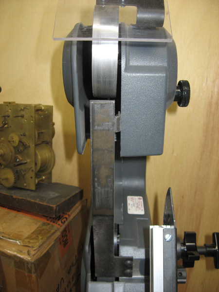

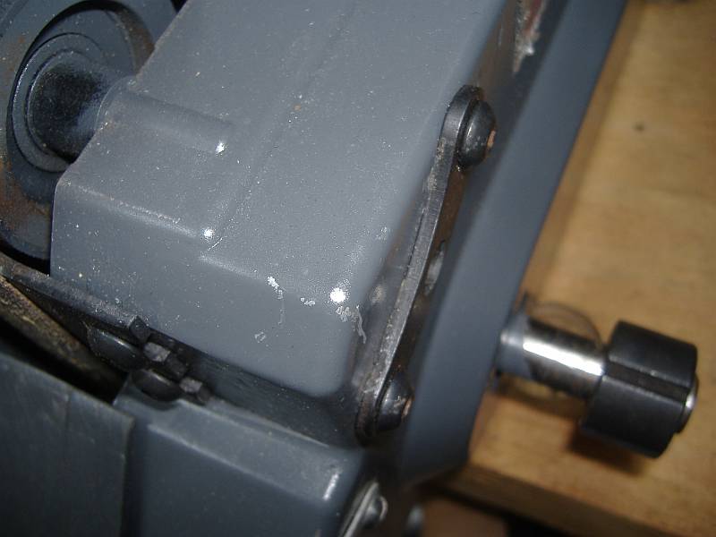

[ATTACH]9190[/ATTACH]
It appears that the attach point for the platen should have been milled in a manner similar to the adjacent attach point for the idler wheel.
[ATTACH]9191[/ATTACH]
As configured the platen is too far to the left. If I remember correctly my dad bought his sander about a year later, his has the identical problem.

I would bet on owner modification or reassembly error. You might look the unit over and see if you can find the socket head screws somewhere else on the machine (maybe even the spacers]reible wrote:Well I guess we don't have a large enough sample size to say if my second sander is made the way it designed or if someone has modified it. When I get some time I'll check how the normal table mounts and see if it might work better with spacers and different screw heads.

horologist wrote:Ed,
Mine isn't that old. I have a 555309 serial 08-04-08 that is like #1.
I do have some alignment issues as well. The center of the cup aligns pretty well with the center of the wheels, my trouble is with the platen.
Is your sander the same?
Troy
Hi,SDSSmith wrote:I would bet on owner modification or reassembly error. You might look the unit over and see if you can find the socket head screws somewhere else on the machine (maybe even the spacers]
I see some over spray gray paint evidence so I have a feeling it was apart. I think you are correct about the parts issues. My next step will be to take the "good" one apart and measure the spacers and see if I have any that match. The screws unless they are somewhere else on the machine I will have to shop for.
At least I think I understand what is going now at least.
