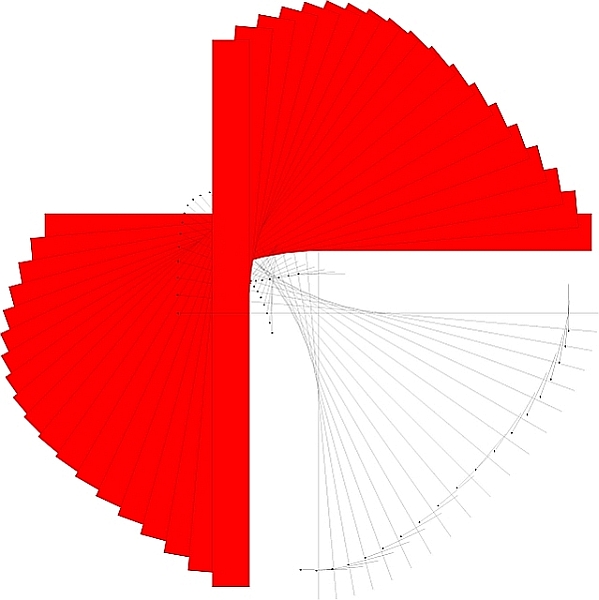

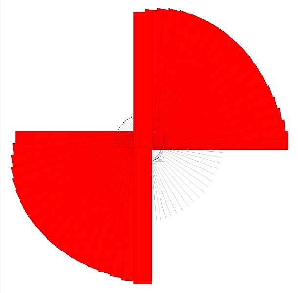

I have made several attemps to solve several problems I saw in my prototype. I have solved all of those except for a easy way to keep the machine upright if the table end is overloaded. There must be 50 ways of doing it but they are not how shall I put it... elegant, or too elegant (a double 4 bar linkage).
The major flaw on mine was the location of the turning point of the support when the table tilted. To be honest I was thinking I do so little work with the table tilted it wouldn't matter to me but then I know that is just not good engineering.
The sumulations show what happen on my prototype and then the correction.
[ATTACH]1100[/ATTACH]
[ATTACH]1101[/ATTACH]
How to see how bad this looks after conversion......
- table rotation bad.jpg (124.13 KiB) Viewed 12979 times
- table rotation.jpg (95.49 KiB) Viewed 12966 times
