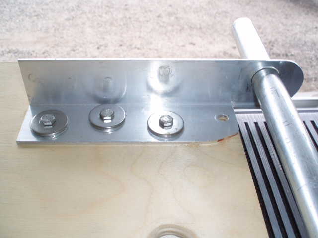

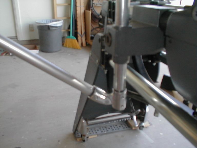

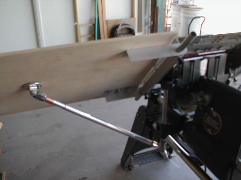

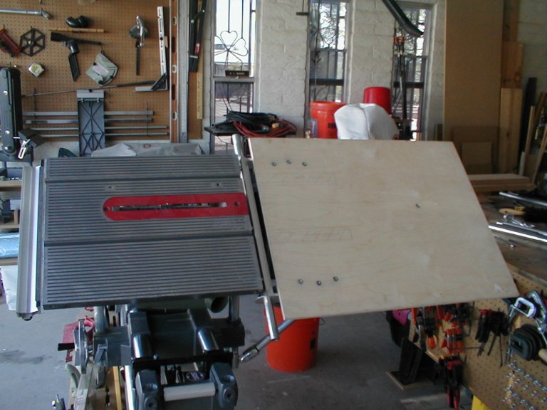

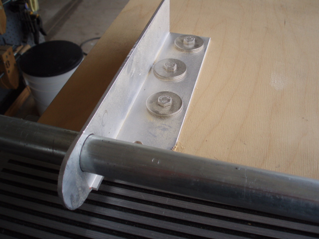

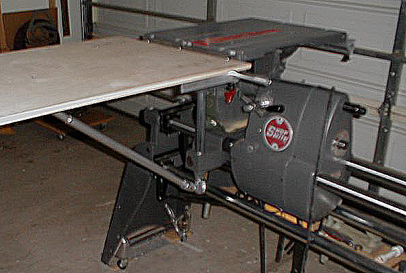

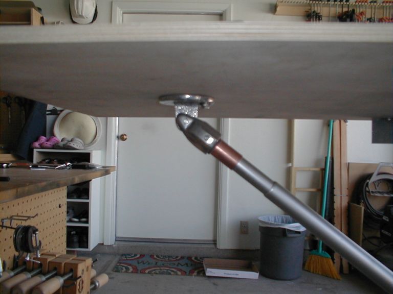

Again, there has been a bit of chatter about an outfeed table that tilts and follows the table up and down. I even see that someone is offering plans for sale on ebay.

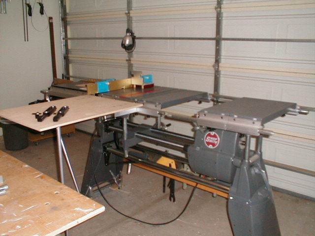

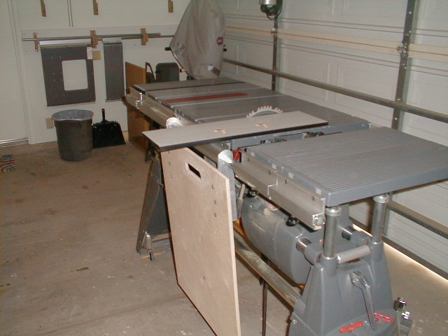

Here are some photos - (two posts worth) of a table I have concocked.
- Outfeed Table (Idle).jpg (58.87 KiB) Viewed 31060 times
- Outfeed Table Brackets 2.JPG (52.57 KiB) Viewed 31024 times
- Original Outfeed Table.jpg (59.87 KiB) Viewed 30990 times
- Adjustable Outfeed Table.jpg (220.49 KiB) Viewed 31020 times
- Table Brackets.jpg (47.79 KiB) Viewed 30994 times

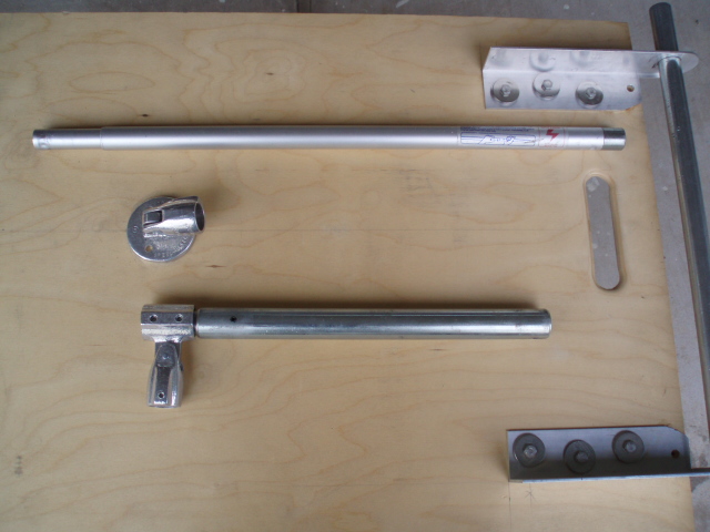

Addendum: Outfeed Table; Tilting and Height Adjustable

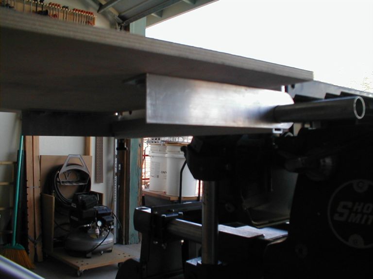

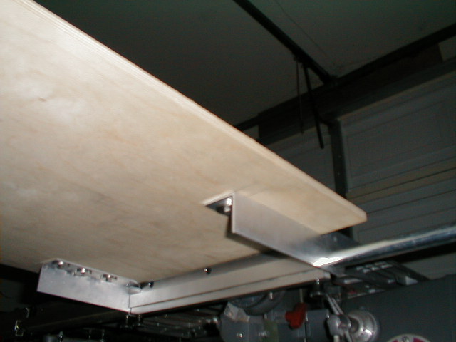

Some other shots that I hope would allow you to build one of these of your own.
The inspiration came from Nick. See post #10 of this thread: https://forum.shopsmith.com/viewtopic.php?t=376
- Table Support.jpg (54.37 KiB) Viewed 30913 times
- Tilt Far Left.jpg (82.06 KiB) Viewed 30891 times
- Tilt Far Right.jpg (45.51 KiB) Viewed 30856 times
- Vertical Support Tie Bar.jpg (49.63 KiB) Viewed 30901 times
- P3150001.JPG (129.11 KiB) Viewed 30887 times
2nd Addendum; Outfeed Table

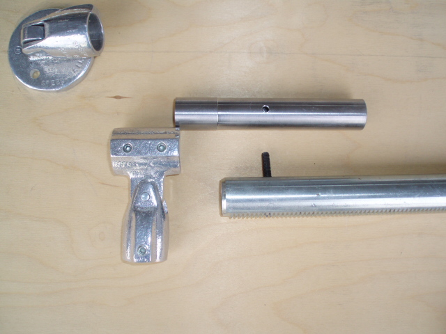

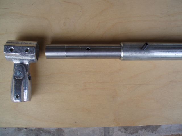

Some additional photos that are intended to detail the vertical support bar and the attachment to the Shopsmith Main Table.
Don't know how I got attachments rather than inserts. I'll have to try this again; I hate accidents that work. The reason why I did an edit though: - The setscrew that you see in the photos gets set flush with the main table leg; this allows the table to be removed without removing that short stub piece. Once installed, that piece could be made permanent though I would not advise that. You never know what the future may bring.
I've thought about elongating the hole that the support tubes insert into. This would allow the table to be dropped down onto the support tubes rather than have to slide the support tubes through the holes. Also, the bracket needs a spacer inserted under it, the thickness of which would align the table top heights. Right now the outfeed table is about 1/2" below the main table top height.

I ordered the parts out of an outlet in Phoenix. They are actually commercial hand rail parts and they are manufactured by the same company that does some of the hardware for the Shopsmith adjustment table legs (the parts that attach to the horizontal table support tubes).

Thank you Charlese for the kind words. However, I must confess that I have learned very little about photography. What really happened was a gift from my grand daughters' boyfriend. He gave me a 7.4 megapixel Olympus digital camera for Christmas.
I just point and shoot. The camera does all the work.

Hi Dusty,
That is very impressive.
I think that you could market that table. Is this the final solution? That is to say, is it complete or are you still "engineering" it? For instance: How does this table deal with the miterbar?
Your pictures don't show any miterbar relief cuts. I think that it is a great idea!
Tim
The table top is just a piece of plywood. I used that for the prototype. The finished table will be a bit thicker and made with something with a smoother surface. Something that can be waxed. Then I will route in the clearance slots for the miter bar.
Right now the miter bar rides above the table top surface.
I also must decide the size. I tend to oversize everything like this so I need to do a bit of study.
So I guess you could say that I am still "klugging" it.
