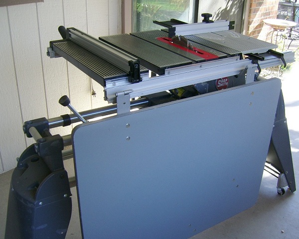

Hey Dusty, that Shopsmith 3000 mod. looks pretty nice on your shorty. When I first designed the brackets to make this mod. I never got around to attaching it to a short setup, yours makes it look pretty good. I've been out of pocket for awhile and haven't had a chance to use my shopsmith 3000. Since I have a folding outfeed table that hangs on the rear rail, I've wondered how well I could tilt the main table to do bevel/miter cross-cuts. Well, I got a chance to see today. I needed to do a 40 degree cut on a couple boards. It worked great. The outfeed table didn't hinder me at all... and the sliding miter table works just as smooth operating in tilted fashion as it does flat at zero degrees. Here's a picture with my outfeed table attached and you can see what I am talking about. That table must weigh at least 30 - 40 lbs... it's pretty heavy. I was a bit concerned that I might have problems tilting the main table with it hanging off the rear rail.

Ron, is that a Ryobi outfeed table or your own design?

Peter -- The outfeed table attached to my saw is the Ryobi design. It was offered as an accessory to the BT3000. I found it to be a nice addition, however, it is large and heavy... 40" wide x 30" deep and 3/4" thick. For the BT3000 in a static setup it works very well, but attaching it to my Shopsmith 3000 gave me a little concern... I was afraid the large mass hanging off the rear rail in a mobile situation might introduce some stresses that could be problematic. So far it is working well. I may eventually develop my own design to reduce some weight.

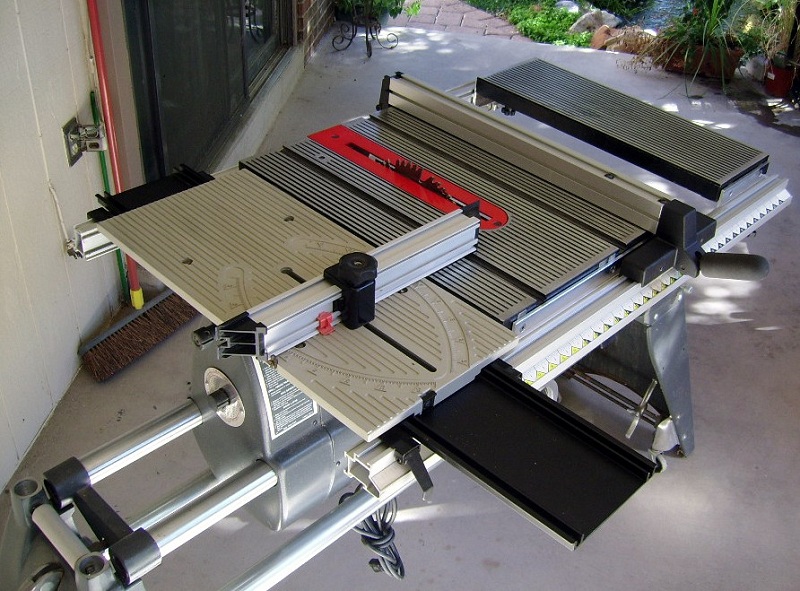

The Incra equipment is very nice. If you need to make high accuracy cuts, it looks like their product will save you time and give repeatability. When I designed the interface hardware to adapt BT3000 parts to the 510 (what I call my Shopsmith 3000) I wasn't trying to duplicate what Incra has, instead my intention was to make the 510 a much more versatile saw. Having spent many years using the BT3000 I grew very accustomed to its unique features. When I acquired a Shopsmith 510 and began using the table saw function I felt I was going backwards. Don't get me wrong, the Shopsmith indeed has lots of desirable features and is versatile, that is why I got it in the first place, however, the table saw I felt left a lot to be desired. I missed what I had with the BT3000. This is what motivated me to adapt the BT3000 components to the SS. I knew that if I could adapt the rails to the SS table I could carry over many of the other desirable features such as; smooth operating rip fence, sliding miter table, router/accessory table, folding outfeed table, etc. since their installation is designed around the rail system.
After a couple years and a couple prototypes I finally got it working the way I wanted. Here's a pic of my setup on a standard Shopsmith 510.
