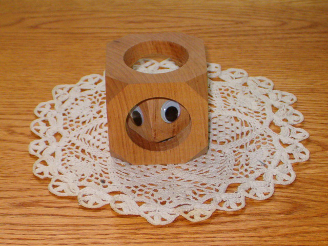

I glued the shaky eyes on the inner box for cuteness and too hide the center hole made by the forstner bit.
There is just two little secrets to making a Box in a Box. First, don't try this without firm clamping! Holding by hand will surely end up with hurting fingers. Second, after finding the centers of the sides of the original block, select your forstner bit and drill the depth slowly. Only drill as deep as you need to show a little light on each side of the inner block. In fact just sneak up on that depth on all 6 sides until you see that the inner block is ALMOST free. Then finish cutting the inner block free with a sharp knife.
Here is a pix of the finished project again.
[ATTACH]19638[/ATTACH]
A funny note to this project - I gave it to my son for a Christmas stocking stuffer. He took it to work to share with the other engineers. They all thought it was a puzzle and tried and tried to take it apart. They also couldn't figure how it got made.
