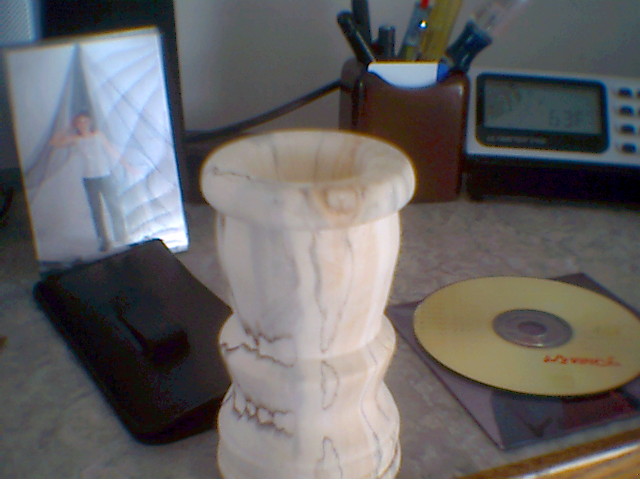

Thank you for the knowledge. I am learning so much about woodworking from here. I thank all of you. It really is a fun hobby. I just took a branch from the ice storm and decided to turn it and see what would happen its spalted and really pretty. Wow this is fun.
