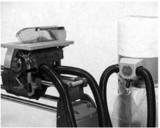

On page 6 of that PDF it shows this. It looks like it would suck up more chips and dust. I can't see how it is hooked up. Does Shopsmith have a guard with two outlets?
[ATTACH]19923[/ATTACH]

I believe that the two outlets were on one of the old 500 lower saw guards

stew wrote:I believe that the two outlets were on one of the old 500 lower saw guards
Yes, one of the older lower saw guards provided two outlets. A second outlet, properly located, would help the current lower saw guard.
