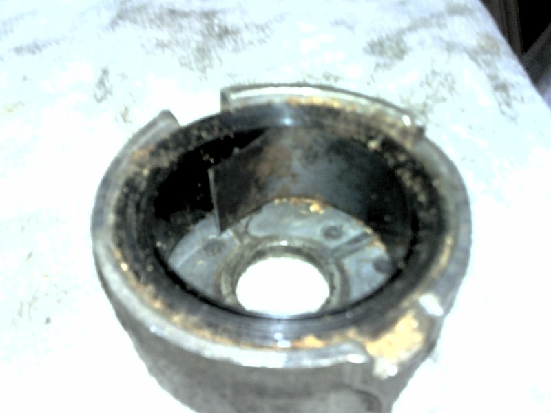

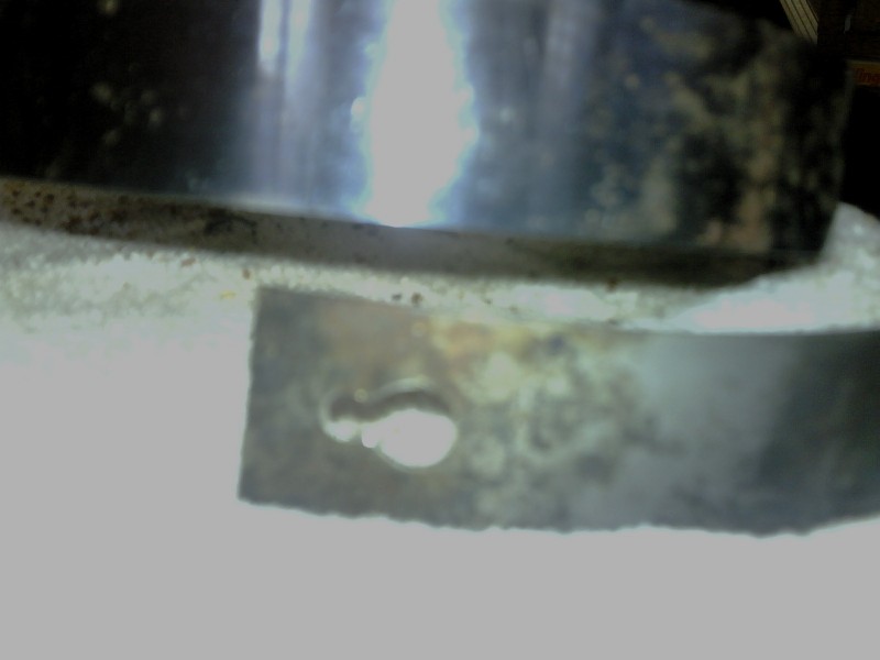

fredsheldon wrote:Speaking of springs, on one of my 10ER's the end of the spring where the hole is broke off. How does one go about replacing the spring? Or do you just replace the housing with spring already installed. How do you rewind the spring if you were to remove it. Or is that even possible :eek: I don't see any problem with the spring not working other than in drill press mode it might take more effort to raise the quill. Since I'm going to use it as a lathe and Jig saw it won't be an issue I don't think. Am I missing anything here?
One of my 10ERs came with a broken return spring.
[ATTACH]20447[/ATTACH]
I drilled new holes, one the size of the retaining pin head and one the size of the shaft, slightly overlapping.
[ATTACH]20448[/ATTACH]
I left the points where the two holes meet so there was a bit of a snap when it went onto the pin. The spring drilled easily and I don't remember it being that hard to reinstall, the 10er spring is more accessible than the one on the Mk5/V.
A fairly easy fix and the price is right:).

rpd wrote:One of my 10ERs came with a broken return spring.
Did you uncoil the spring outside of the housing or just pull out enough to drill the new holes? I have visions of it unwinding in an explosion and taking out my nose in the process as you remove it from the housing :mad:
Fred Sheldon
The Woodlands, Tx
rpd
Posts: 3045
Location: Victoria, B.C.
Post by rpd »
fredsheldon wrote:Did you uncoil the spring outside of the housing or just pull out enough to drill the new holes? I have visions of it unwinding in an explosion and taking out my nose in the process as you remove it from the housing :mad:
I took it out of the housing, the coil will get a bit larger but there isn't a lot of tension on it.
