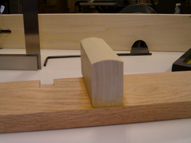

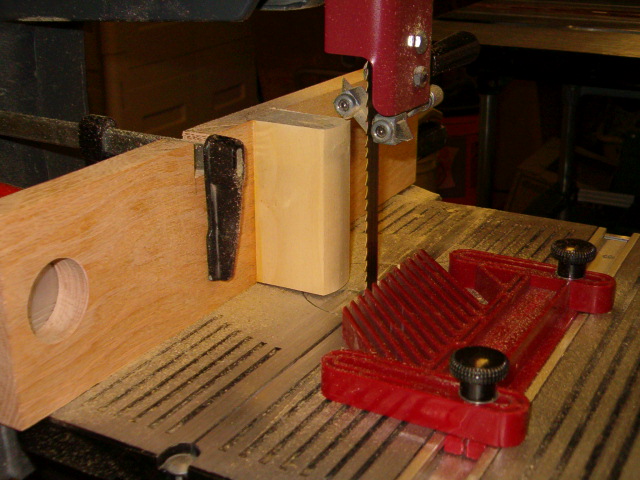

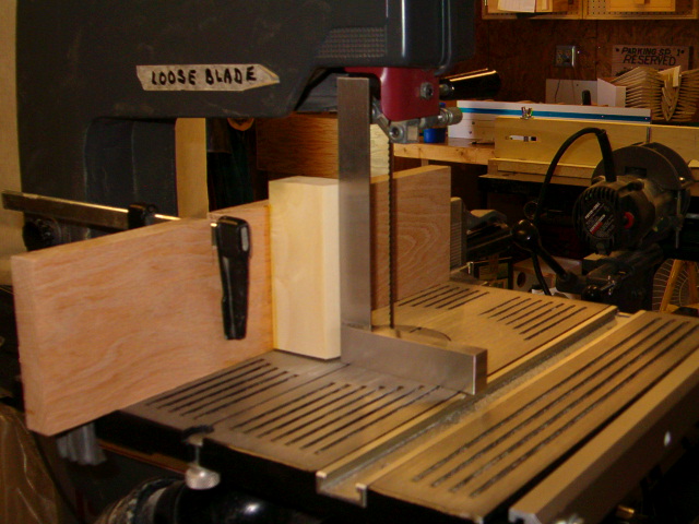

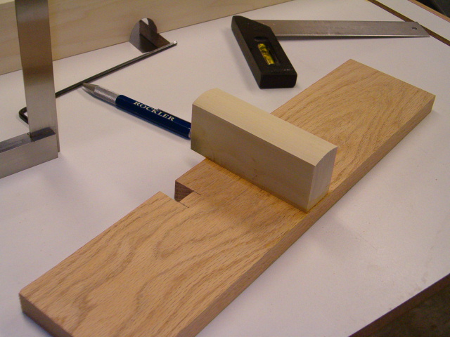

The Kreig re-saw fence attachment is an add-on that gives single point re-saw adjustment. You don't need a Krieg fence to get this feature. The identical feature can be home made to attach to the Shopsmith fence. All you need are a couple pieces of wood and a clamp (with a little woodworking).
