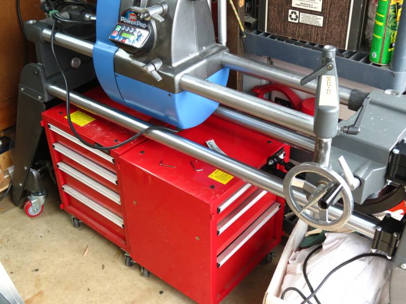

I don't have many options at this time, so for now I have pulled the pins making them into two independent cabinets. The one closes end I left turned with the drawers facing front. The second cabinet I rotated 90 degrees and the drawers now face the other end of the shopsmith. Not as convenient but at least are out of the way.
[ATTACH]21062[/ATTACH]

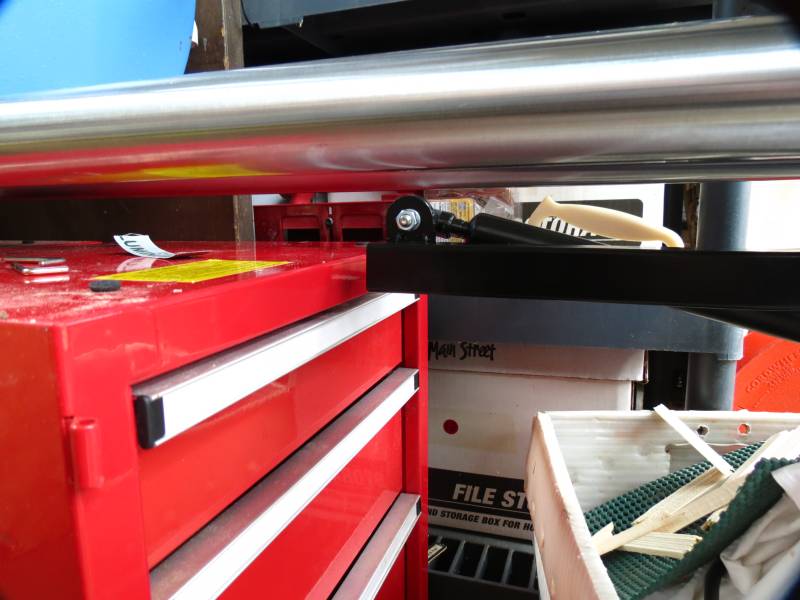

For those of you who might be wondering, this is a picture at shows how close/far away the fit is in vertical terms.
