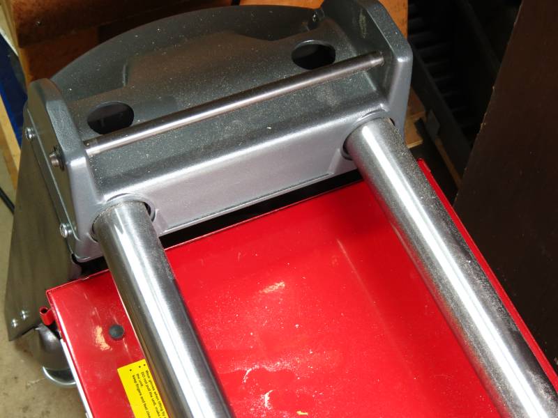

This is test one, machine is up on the highest position of lift by the casters. The machine is sitting on flat section of floor. I have the cabinets in paint scrapping closeness to the end (you would need more room to move them so this is not practical). BTW I did scrape paint.
[ATTACH]21003[/ATTACH]

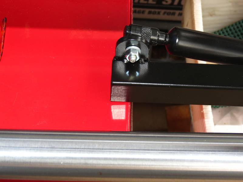

With the cabinets square to the leg end this is the shot of the lift assist resting on the cabinets.
[ATTACH]21004[/ATTACH]

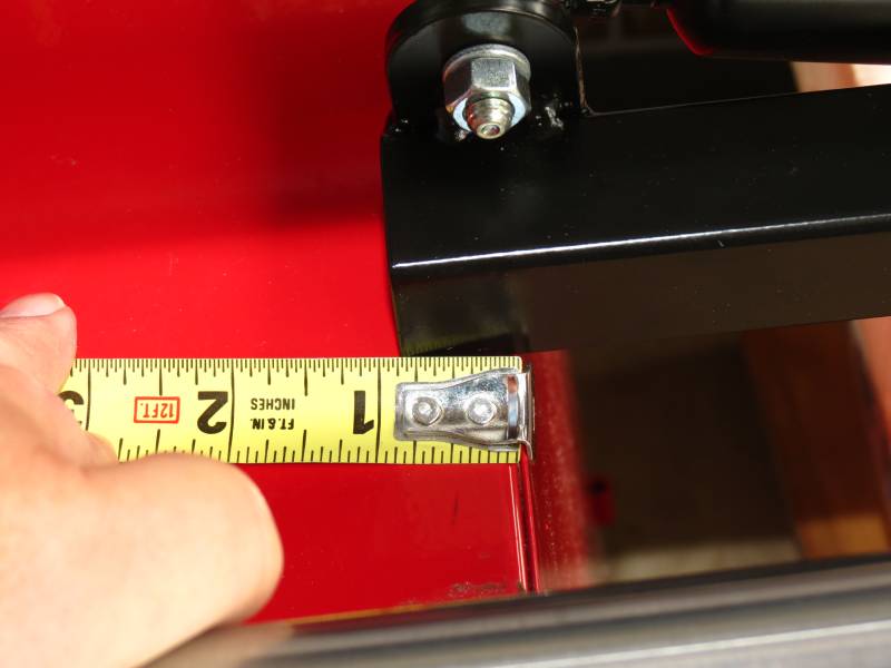

Keep in mind the cabinet had been placed first before dropping the headstock down. This is also an arc so what you are seeing is the lift hitting before it can reach its rest/lock down position. The measurement at this point is 7/8".
[ATTACH]21005[/ATTACH]

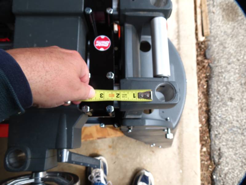

A few things may have changed since you purchased your lift assembly or perhaps you don't have the pro version. In order to use the dual tilt you need to remove the one end of the gas cylinder. There is now a quick connect/disconnect the lets you pop it on and off. In order to locate the ball stud and the connector you need to move either the top or bottom mounting position. When I adjusted mine for a good fit it meant the top mounting, the one that positions the arm, to no longer be against the end. This moves the arm in the wrong direction cabinet wise. It looks to be about 3/8".
[ATTACH]21006[/ATTACH]
Even if I had the 3/8" back it is unlikely to fit.
