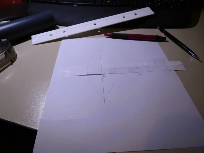

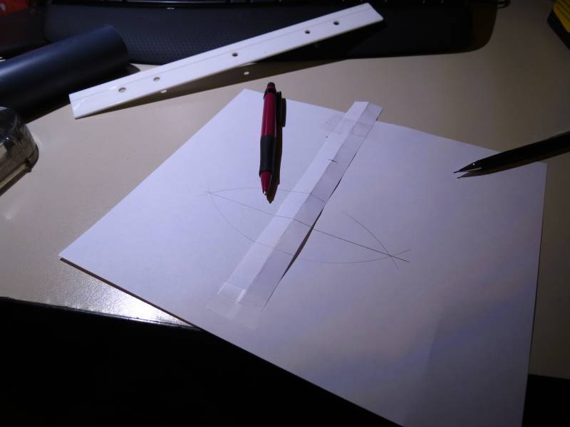

After you draw the arcs you put a line on the strip, this is half the distance between end points.
[ATTACH]21408[/ATTACH]

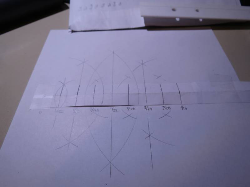

Add a few reference numbers.
[ATTACH]21409[/ATTACH]

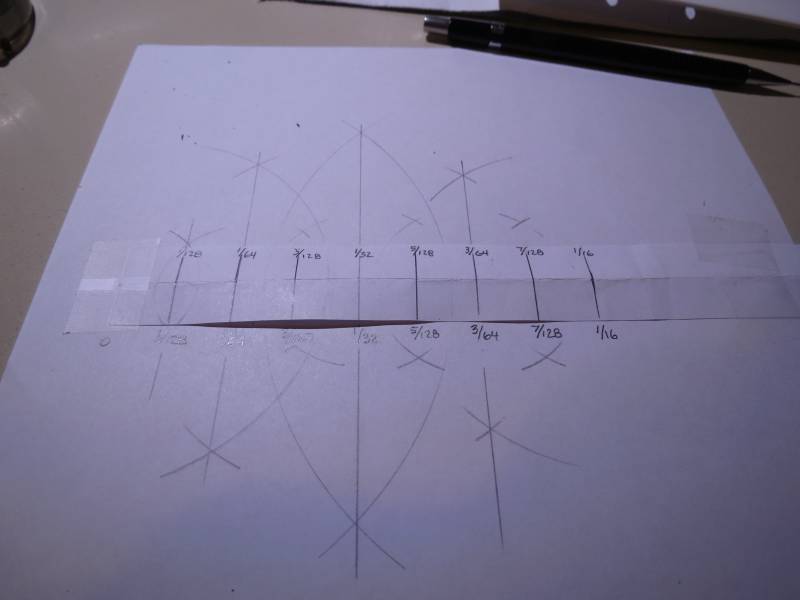

Using the same process you can subdivide the line in to many parts, each line being half the distance of the one before.
[ATTACH]21410[/ATTACH]

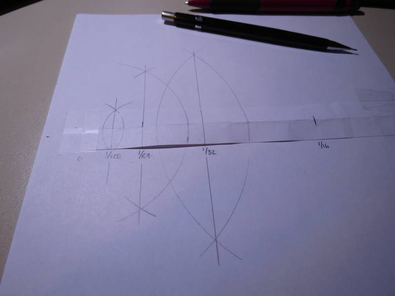

I went to 1/128 but one could have gone even finer.
[ATTACH]21411[/ATTACH]

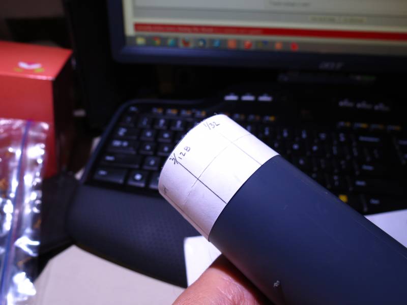

Then I put the markings on the strip.
[ATTACH]21412[/ATTACH]

I plan to trim the strips so that their height fits on just the smooth area. The laminating process is so that I can make a mark on either using a dry erase pen and then wipe off that mark when finished.
