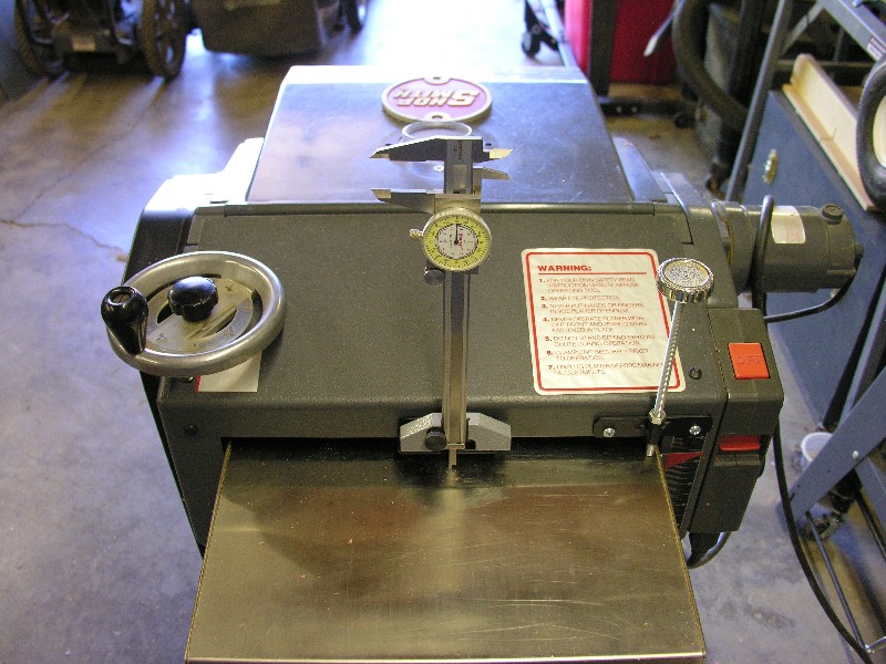

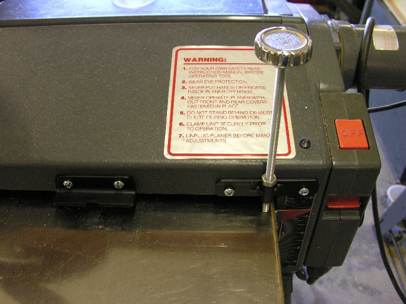

I have used my SS 12" planer for over thirty years and it has served me well, but recently I found myself wanting a bit more control over the machine. A couple of pictures should explain how I set for final thickness with a caliper and use the stop rod to end up at that setting.

ldh wrote:I have used my SS 12" planer for over thirty years and it has served me well, but recently I found myself wanting a bit more control over the machine. A couple of pictures should explain how I set for final thickness with a caliper and use the stop rod to end up at that setting.
ldh
[ATTACH]21941[/ATTACH]
[ATTACH]21942[/ATTACH]
Very neat. Excellent solution. One question though. How do you go about zeroing?

BigSky wrote:Very neat. Excellent solution. One question though. How do you go about zeroing?
The minimum thickness that the machine can plane to is 1/8", so I installed the ledge to read 1/2" on my caliper at the minimum thickness setting on the SS. The 1/2" measurement on the caliper would yield a 1/8" thickness, so that is the relative zero. Any thickness above 1/8" would have a setting of
+3/8 on the caliper. For instance setting the caliper to 3/4" and bringing the table to this setting then adjusting the stop to the table will yield a thickness of 3/8" time after time. As you can see I zero the caliper on zero and just have to remember to add 3/8" to the caliper when setting the table. Most of the time I use a fractional caliper, but when I really really need to get even closer I use a caliper in thousands or a feeler gauge under the stop. If you build one of these you will quickly find how easy it is to get that perfect
.1875 thickness you needed.
ldh
With a digital caliper you could 'zero' it at .375 and it would then be direct reading.
