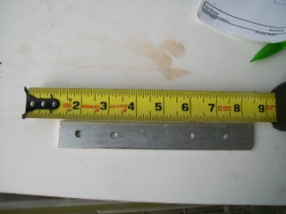

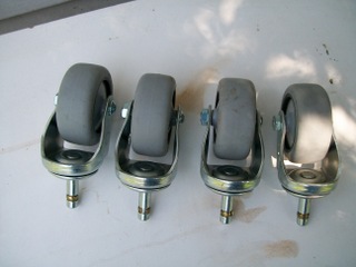

I found a box of 3” casters that I brought a few years ago to install on the MINI and SHORTY Shopsmiths I was selling. The customers was not interested in the additional cost at that time so they were packed in a box and forgotten. I made a metal drilling template for the new holes using a prior post for hole location. I drilled one leg and installed the casters. The leg was only lifted at the second lift wedge position. I determined new hole locations (1 ¼” higher) and made a new drilling template.

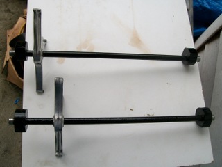

I noticed that the foot pedal could contact the caster closest to it. I marked the location of the foot pedal lever and the lift rod near the lift wedge for alignment when the foot pedal is moved 1 ½” further from the lift wedge. I used a large flat blade screwdriver between the caster housing and the lift wedge to ply the lift rod from the housings. I used the screwdriver to install the lift rod back into the housings. I did not remove any roll pins from the smaller connecting rod between the two housings. I secured the lift rod in a vise and used a 8p common nail with the end ground flat to remove the 5/32” foot pedal roll pin. I used vise grips to initially hold the nail to prevent the nail from bending and damage to my fingers. I center punched the lift rod about 2 ¼” from the lift wedge and drilled a 5/32” centered hole. Using the prior marks and the nail to position the foot pedal, I hammered the 5/32” roll pin back into the foot pedal pushing out the nail. The following picture is with one caster set foot pedal in the original position and the other caster set with the new foot pedal location.
[ATTACH]21934[/ATTACH]
The new leg holes were perfect in that it allows the casters to be moved by hand when the legs were setting on the floor. The first and second lift positions allowed the Shopsmith to be easy to move now. This was quite an improvement allowing for my rough concrete floors.
