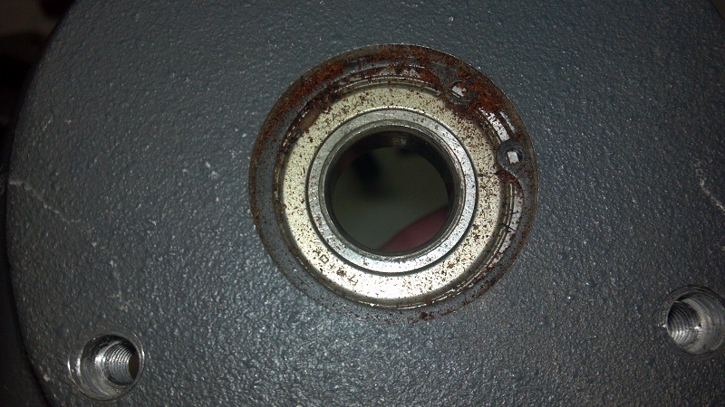

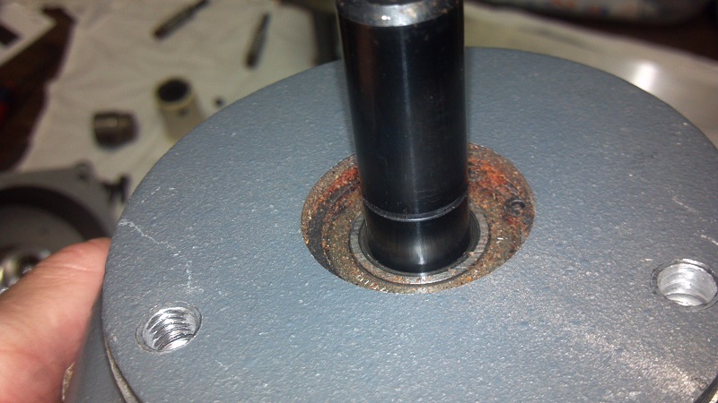

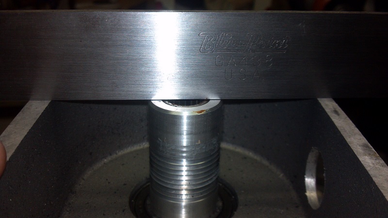

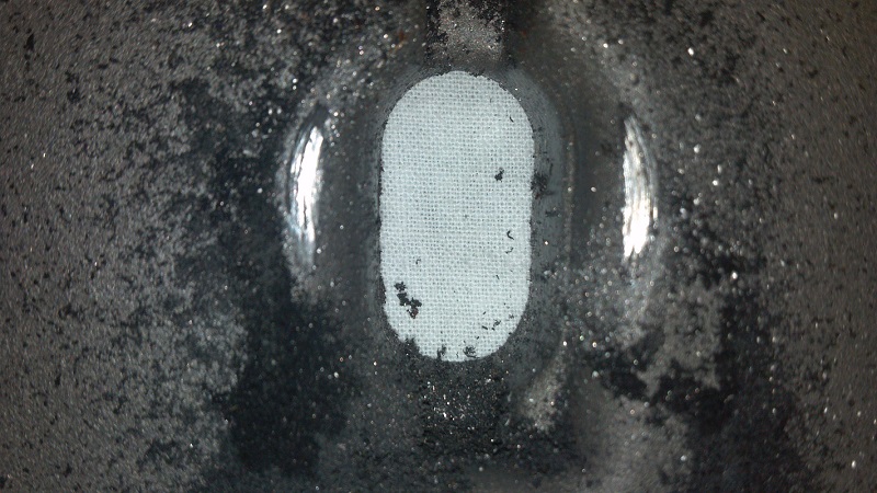

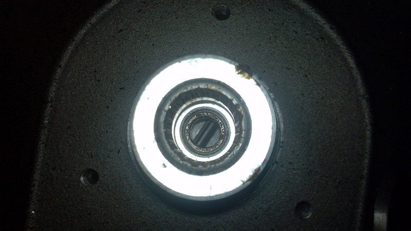

A better look at the metal damage on inside of reducer case.
[attach]22069[/attach]
A look down inside the upper input sheeve shaft hole.
[attach]22070[/attach]
Upper input sheeve in relation to case separation point
[attach]22071[/attach]
Bearing housing and output shaft minus the spacer and snap ring.
[attach]22072[/attach]
Same minus output shaft.
[attach]22073[/attach]
