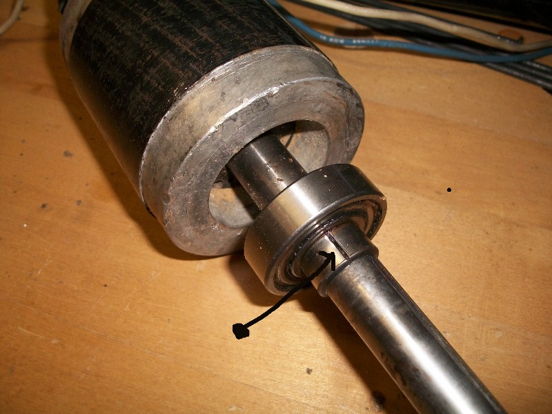

As I look at this bearing on the motor shaft, it appears to actually be mounted on a sleeve that rides on the motor shaft. (arrow) Is that what I'm seeing? Or is there just a slot in the shaft?

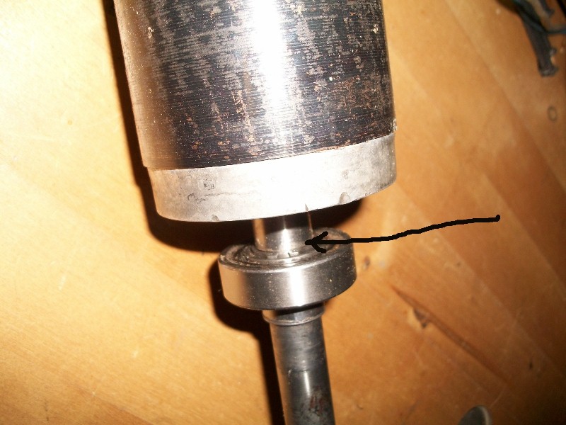

Also, at the back of the bearing is a retaining ring (arrow) is there any reason to remove this?

It's a challenge getting the bearing off because my bearing puller is not long enough to reach down the long shaft. I've tried an open ended wrench behind the bearing & rapping on it. Any other ideas?

Clues to puller 'shortness' reside here!
Do realize that is a mark VII motor shown.
The 'collar' looks like the fan sheave spacer. It should just pull off.
The retaining ring can 'get in the way' of removing the bearing. If you leave it on, make sure the puller 'misses' it.

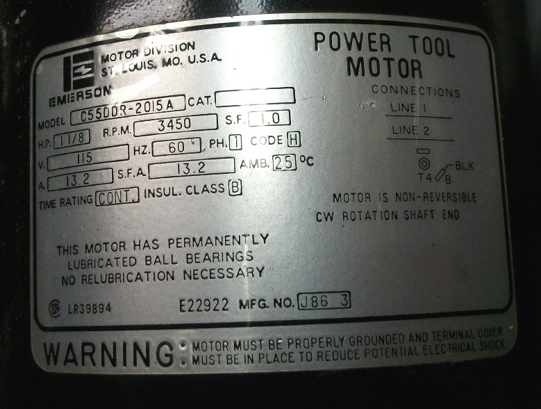

Here's a pic of the motor label. Non reversable. It came out of a MK5 that appeared to un-opened prior to me getting into it. Any other thoughts?JPG40504 wrote: Do realize that is a mark VII motor shown.
[ATTACH]22306[/ATTACH]

My dad's 1951 10er, 2 more 10er's, same vintage, a Goldie MK5, a 510 shortie with 34inch tubes, bandsaw, jointer, jigsaw, belt sander, a ton of small SS goodies and still looking...you just can't have enough Shopsmith stuff
Slip the armature into a sturdy 'fork' and apply force to the end of the shaft.
If impact force, protect the shaft end.
Provide soft 'landing' area!:D

Once I pulled off the sleeve (shieve spacer), I was able to use the open end wrench to tap the bearing off. I had a spare, one of the same ones I keep to put in the 3/4hp GE motors. All back together & runs great. You learn a little more with each project. If you do enough projects, you begin to think you know it all.
