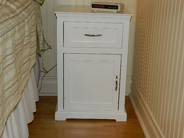

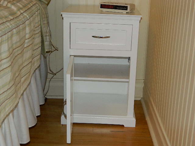

since I made anything worth talking about but this is my latest project. My granddaughter wanted a night stand for her bedroom as a birthday present. Since we could not find one at a price we wanted to pay, I said I would make one. That was back in June, as was her birthday.
It is based on the plans from a fancy vegetable bin I made a couple of years ago, and modified to be smaller and have a door.
Those of you who may remember some of my "weekly blog" posts of a few years ago would also remember that I don't do anything the easy way. :D This was no exception. I won't bore you with all of the details, but since my face frame openings were not exactly square, both the drawer and door required a fair bit of adjustment to get them to fit.
Now all we need to do is find a way to get it to her in Niagara Falls, several hundred miles away.
John
[ATTACH]22548[/ATTACH]
[ATTACH]22549[/ATTACH]
Sorry for the picture quality. An angled view would have shown the face frame extends about 1/4 inch over the side to give it a better look.

Looks good, John
SS Mark 7 PowerPro, 2 SS Bandsaws, SS Belt Sander, SS Jigsaw, 13" Steel City Lunch Box Planer, SS Jointer, Jet 22-44 Drum Sander
Atta Boy, John! Yes, it's been a while, but both of are still here:)
Super nice work on that night stand! As always, your verbage is a bit understated, however that little cabinet is a beauty! Can't see a thing out of square.
Me too! can't make anything perfectly square, just have to "fit" the pieces.:rolleyes:
john
Posts: 1048
Post by john »
Chuck:
Thanks for the encouragement.
You are right, the picture doesn't really show it out of square, until you try to fit the pieces. Actually the door is version #2. The first one had door frame pieces that were only 1.25" wide and by the time I "adjusted for the error", the top and bottom pieces were visually narrower at opposite ends. The new frame is wider and cut differently so the difference doesn't show as much.
I won`t mention the error on the panel as I am too embarrassed about that one.
The drawer had similar problems but not as bad.
Some year I may get it right.:D
John
Looks like you got it right already!
