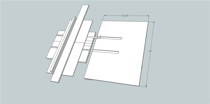

[ATTACH]22579[/ATTACH]
Concept drawing of my bevel sled
Stop block mounted on the outfeed table limits forward motion so that I do not cut the sled in half.
Sled extends to the rear of the fence to make the whole thing more rigid.
I clamp the work piece to the fence on both sides of the blade to provide the needed "control".

I built the 45° sled referenced above and find that it's easy and safe to use. Mines not adjustable, but it easily could be made so.
As it is, fine tuning is simple with the tilting table.
Sled extends to the rear of the fence to make the whole thing a rigid.
