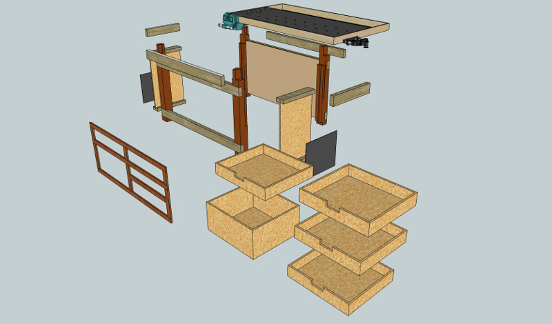

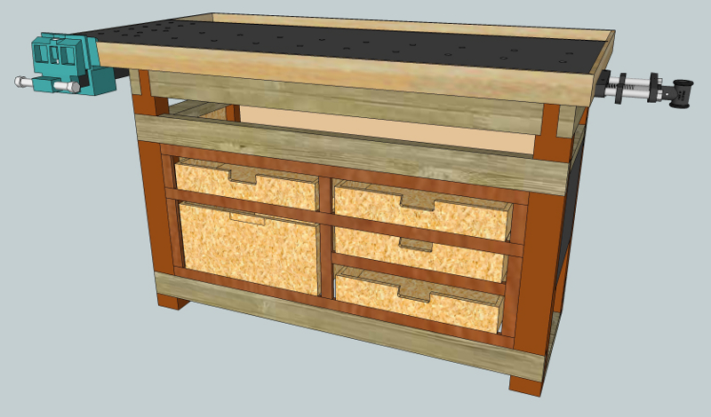

I have to say that SketchUp often causes me to pull out the few strands of hair I have left and add more wrinkles where the were already plenty, but thanks to Dusty and his encouragement I have a spring project.
[ATTACH]22985[/ATTACH]
[ATTACH]22986[/ATTACH]
The top will be 2 layers 3/4" MDF with one layer hardboard so I can replace it as it wears (wrapped in oak), but most of the rest is some 4x4 posts, 2by and scraps I have laying around. The big ticket will be the vices. The barely perceptible gap at the back is a tool trough and the drawers are still a construction thought in progress (just know the size not the materials). The large gap between the top and drawers is to accommodate holdfasts. There are no feet as they will be a custom height when I decide the appropriate height of the top surface.
I've never had a proper bench and was not ever certain I would, but Dusty gave me the confidence to pursue Sketchup. I built this in an exploded fashion so that I could "assemble" it and found a couple errors and was able to rectify before creating a cut list.
So Dusty, if the computer gremlins are gone and you are still able to get to this forum THANK YOU!!
Ben
And yes, I know there is no handle nor opening on the big drawer. I tried but it's a component/group thing and I wasn't going to take the tiime to explode it to fix it ir redraw or ??? But I do know that I will have some fashion to open it :rolleyes:
