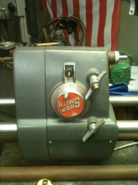

oldskull wrote:It is made by Magna Engineering and it has a 3/4 hp motor. Where is the inspection plate? The serial number I found on the round plate on the end of the headstock.
The 'inspection plate' would be the logo on the back side, however that 'vintage' does not have an inspection hole under it.
I am assuming that from the sn. I believe you have an 'A' headstock.
Count the screws securing the belt cover(where the sn vent plate resides).
If more than 2(8?) securing it to the casting, you have an 'A' headstock.
P.S. A pix would eliminate the need to 'assume'.

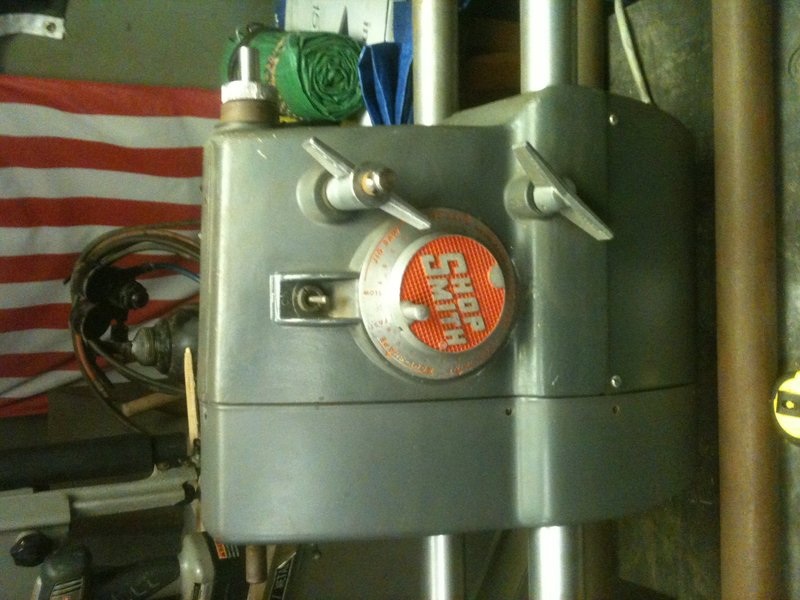

Assumptions correct. It is an 'A' headstock.
[ATTACH]23049[/ATTACH]
Notice more than 2 screws on the belt cover.
The power switch has an interlock that must be depressed to increase speed above saw/joint.
So there is not an access hole under the logo on the backside.
This makes lubricating the control sheave difficult(motor pan dropped ). However that is easily done, and much better access results.

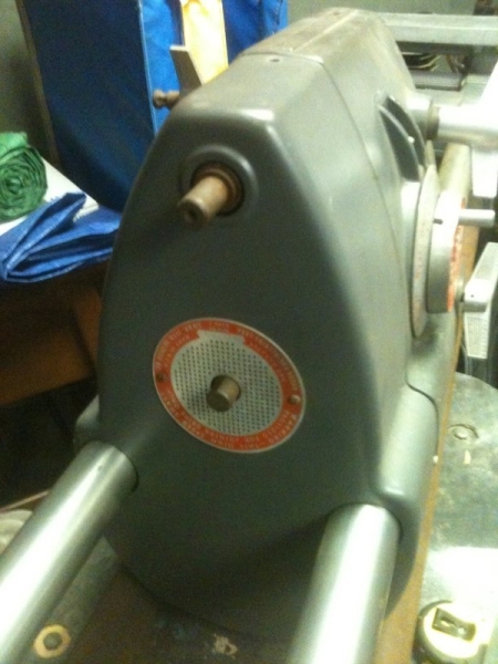

When I went to buy it, the previous owner and I plugged it in to show me that it worked but it barely moved at all. It looked like it wanted to move but it moved about 5 degrees maybe so we shut it off. I took the belt cover off when i got it home and I can spin the headstock by hand. It looks like the belts are okay. I have been cleaning things up and today I mounted the legs so I can get the bottom pan off to see if there is anything physically wrong with the motor or the wiring. Is there anything I should do before assuming the motor is burned out?

oldskull wrote:When I went to buy it, the previous owner and I plugged it in to show me that it worked but it barely moved at all. It looked like it wanted to move but it moved about 5 degrees maybe so we shut it off. I took the belt cover off when i got it home and I can spin the headstock by hand. It looks like the belts are okay. I have been cleaning things up and today I mounted the legs so I can get the bottom pan off to see if there is anything physically wrong with the motor or the wiring. Is there anything I should do before assuming the motor is burned out?

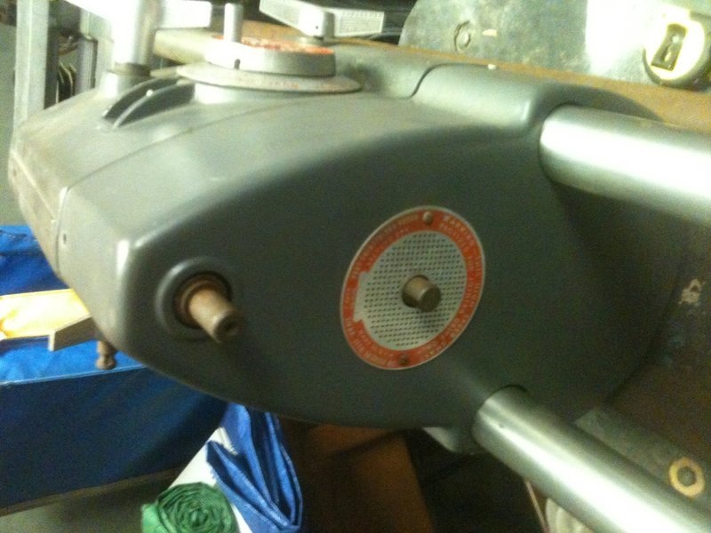

[ATTACH]23066[/ATTACH]
Notice the wide 'rib' on the top, That is another indication of an 'A' headstock.
The 'A" headstock is a sand casting and is heavier than the later die castings. That makes for rougher edges/finish. I prefer them to the later castings. JMHO!;) All the machined bores are the same.
- a headstock back.jpg (175.26 KiB) Viewed 3944 times
