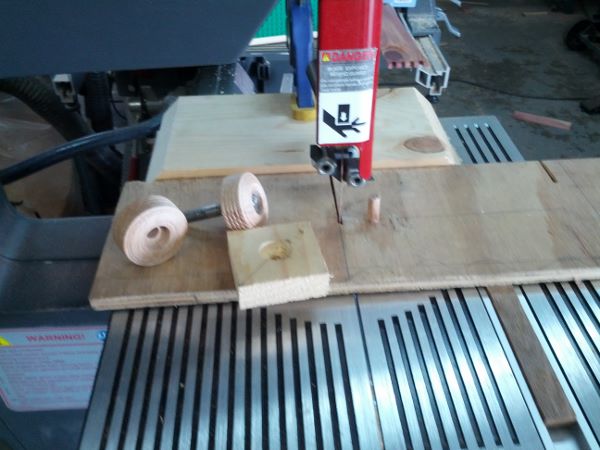

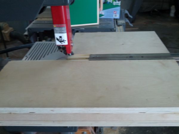

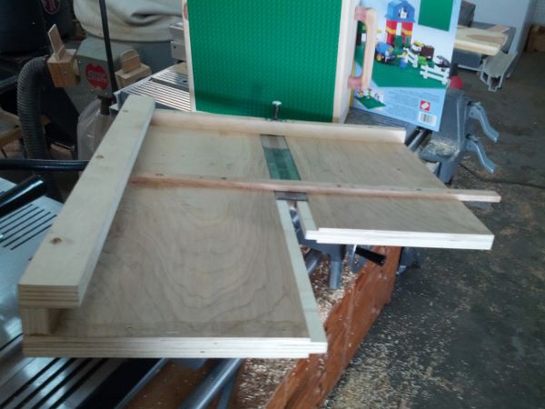

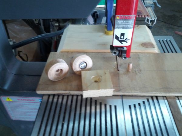

Sawmill noted that he found a jig for himself but thought I would still share these that work for me. One with the plexiglass slide was from Shopnotes Vol 15 I believe and the plans can still be purchased online if you don't have access to the magazine. The other with the dowel was a modification from who knows where. I used a fixed distance for the dowel to cut a two inch wheel that is finished on the lathe. The board with clamp in photo three and four is used as a stop when pushing the square block into the blade. Either of these can be sized for use on the cast iron table. Also look at your PTWFE bandsaw section where a simple circle cutting jig is discussed.
IMG_20131003_142545 (600x450).jpg (47.19 KiB) Viewed 1916 times
IMG_20131003_142630 (600x450).jpg (66.24 KiB) Viewed 1917 times
IMG_20131003_144404 (600x450).jpg (65.53 KiB) Viewed 1918 times
IMG_20131003_144532 (600x450).jpg (69.43 KiB) Viewed 1916 times
