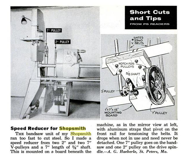

I'm a new Shopsmith owner but grew up watching my dad use one (My dad bought one new in 1982). I found one on craigslist for $550 (510) with belt sander and band saw in great condition. Mine is vintage 1986.
Anyways, I had an idea to run my antique cast hand crank meat grinder off of the shopsmith headstock and saw this thread with the v-belt pulleys attached to the shopsmith.
How are people attaching these to the shopsmith? Its clear on the E and ER models as the motor already has one attached, but on the 510 headstock I would need to attach it to the accessory drive (or high speed drive) or to the quill (though side pressure on the quill probably is bad for the bearings). Does SS sell an accessory to allow attachments like this? I can step down the speed with multiple pulleys, but I can't figure out how they are attaching them to begin with. Anybody have a suggestion?
peterm
Posts: 576
Post by peterm »
In the article below, he removed the drive hub off the accessory shaft and slid on a 2" pulley having a 5/8" center hole:
[ATTACH]23113[/ATTACH]
You could probably run your meat grinder the same way. If the Shopsmith is running at slow (700rpm), the 2" and 7" pulleys shown with the jack shaft would spin your grinder at 100rpm. Is that still too fast?

prmindartmouth wrote:In the article below, he removed the drive hub off the accessory shaft and slid on a 2" pulley having a 5/8" center hole:
Sure that '100' rpm is not closer to 57 rpm?;)
peterm
Posts: 576
Post by peterm »
JPG is absolutely right, first set of pulleys reduce speed at jack shaft by 2/7 to 200rpm and then second set reduce the 200 by 2/7 again to 57.14rpm.
JPG explains later (at #26) in this post, which I forgot about.:o :o :o :eek:

I am not worried about the bearing they get a lot of abuse any way and hold up well. Plus they are cheap and pretty easy to replace. I was just looking at the prices today for a free delta bandsaw I am fixing. I spent less than $4 for two bearings, even if they only last a year they are worth their cost. You can find all sizes of pulleys on ebay if you do go that route. I am using a pulley that came from an old air compressor.
Oh and I found I can get a few lower RPM with a link belt. With mine I can turn the dial down past slow to fast. The link belts are a little thicker than the V belts. I don't know how much of a reduction that is but for a meat grinder I would think you would want as slow as possible.

The speed I'm shooting for is around 70-130 RPM. I'm sure I can get the speed right by changing the pulley sizes (and plugging the numbers into a formula) I'll just have to attach it to the accessory drive of the shopsmith.
Once I get it attached it will all be good from there! Thanks for the ideas.
I really like the picture of that speed reducer attached to the bottom bars, I think I'll set mine up a similar way and just leave it attached there. That's pretty slick, simple, and out of the way, yet easy to get to when needed.
