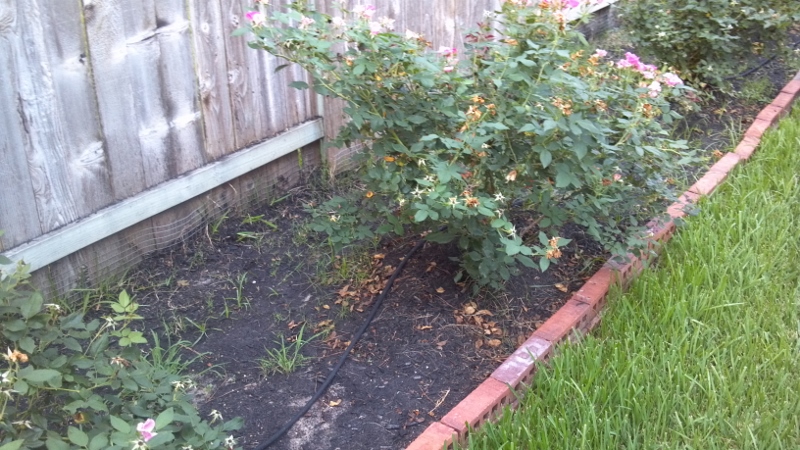

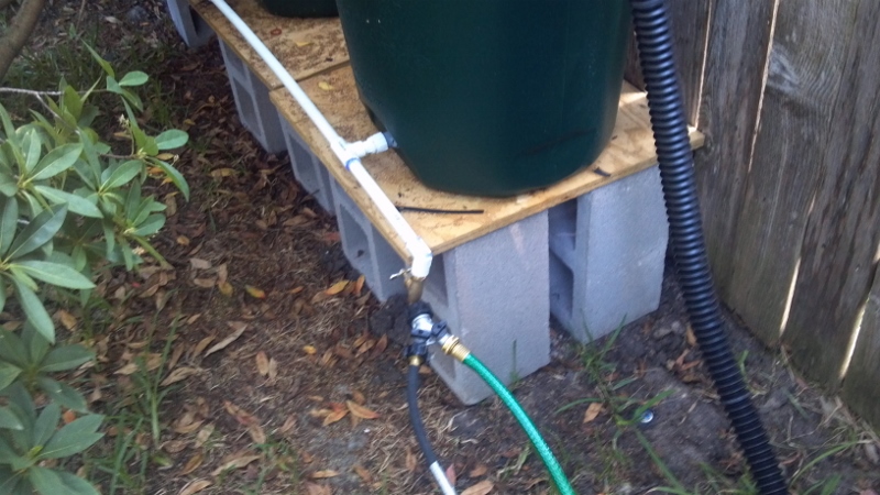

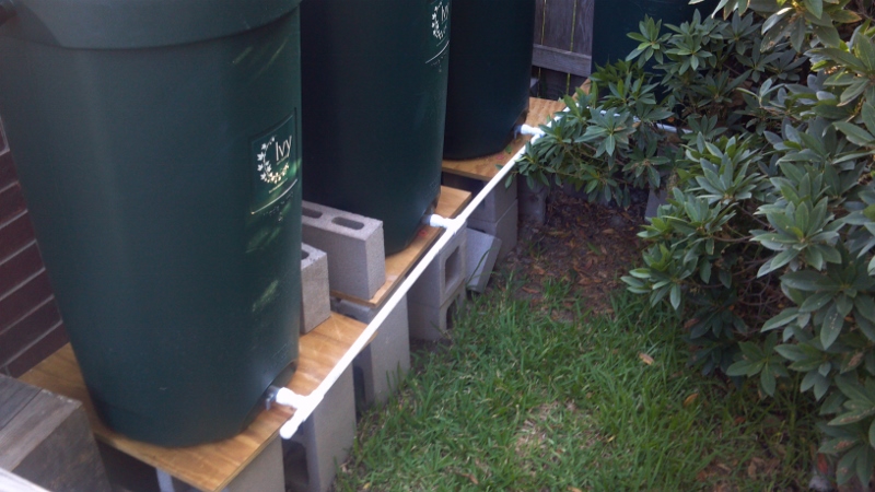

I finally got around to installing a manifold system to connect all 6 rain barrels. I wasn't sure there would be enough water pressure to use the soaker hose but as it turns out it works great. It just takes all night to empty one 60 gallon barrel. I installed a two way diverter valve and run one hose to the back garden and another to the side garden. I only empty one barrel at a time. I had drained 3 barrels up until this last weekend. We got a half inch of rain which recharged two of the barrels.
[ATTACH]22113[/ATTACH]
Splitter valve.
[ATTACH]22114[/ATTACH]
Soaker hose in the back garden.
[ATTACH]22115[/ATTACH]
Three of the six barrels connected to a common manifold. Each barrel has a ball valve to allow for the draining of one barrel at a time.
