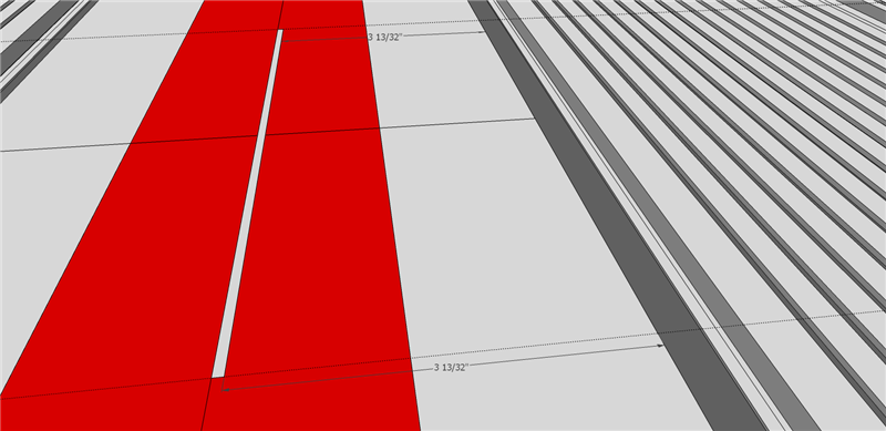

If I had to achieve a proper setup without the use of precision measuring devices, I would start by making sure that the miter tracks are parallel to the blade.
To eliminate the inherent variables of the Shopsmith Mark V, I would make sure that the quill is fully retracted and that all of the locks are secure.
Parallelism is easily verified. A few simple measurements from the blade to the edge of the miter track will confirm that. If the table has been properly aligned, the distance from the blade to the miter track will at all points be the same.
On my Mark V that measurement is 3 13/32".
[ATTACH]23162[/ATTACH]
Because of all the variables involved, measurements on other Shopsmiths will vary slightly but if your table is properly adjusted, the measurements will at all points be equal.

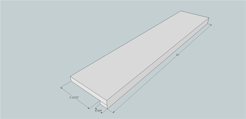

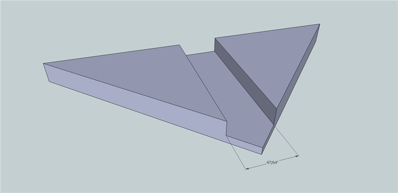

To validate parallelism without doing a lot of tedious measurements, I made this simple jig.
Main Table Parallelism (Custom).png (118.92 KiB) Viewed 4340 times
Jig to Verify Table Alignment (Custom).png (33.14 KiB) Viewed 4288 times
