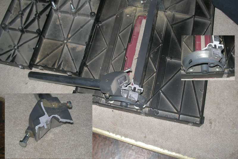

Just purchased a box of 520 parts on eBay (i.e. table, carriage, ext tables, etc) with the intent to upgrade my 510 to 520 status and then use my 510 parts to upgrade my son-in-law's 500 to a 510. Well, good intentions aside, the box arrived today and due to a very poor packing job by the seller, one of the two legs on the main table is broken off (up where the leg attaches to what SS calls the Table Bar & Tube (PN 514344)). Darn and double darn.
[ATTACH]23253[/ATTACH]
The price for a new part is north of $155 which is a definite ouch'y. I am tracking 510 tables on the Bay but I wondered if I could maybe have the broken casting (is it aluminum??) welded? Or maybe someone out there might have one of these lying around just looking for a good home.
Suspect answer is No to welding but thought I would give the forum a try. Desperate times and all.

Welding or brazing will not work well in this high stress area. The heating will weaken the area around the fix. Plus, it is very hard to get the fix to look pretty and function smoothly. I have an extra 510/520 trunnion available along with a real cruddy 510/520 main table without rails. If interested, contact me. Thanks.
- Ed in Tampa
- Posts: 5834
billmayo wrote:Welding or brazing will not work well in this high stress area. The heating will weaken the area around the fix. Plus, it is very hard to get the fix to look pretty and function smoothly. I have an extra 510/520 trunnion available along with a real cruddy 510/520 main table without rails. If interested, contact me. Thanks.
I agree with Bill welding or brazing will not work in this high stress area.
Get the part from Bill and be glad he had one available.
