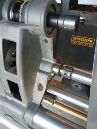

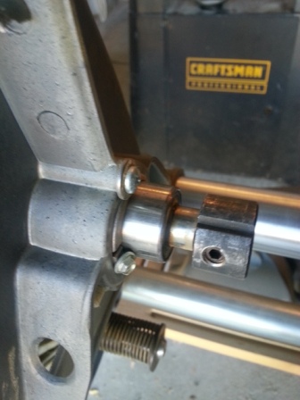

So I took two more pics this morning after reading what you said. So the close up pic, it is sticking out too far correct? that screw is not supposed to be bent like that correct? Is that the screw that need the bigger washer?
[ATTACH]23243[/ATTACH]
[ATTACH]23244[/ATTACH]
- SS Mark V Shaft.jpg (66.65 KiB) Viewed 1425 times
- SS Mark V Close.jpg (57.78 KiB) Viewed 1421 times
ryjonesacct wrote:So I took two more pics this morning after reading what you said. So the close up pic, it is sticking out too far correct? that screw is not supposed to be bent like that correct? Is that the screw that need the bigger washer?
[ATTACH]23243[/ATTACH] About 5/8" too far
[ATTACH]23244[/ATTACH]Yes. Should be straight!
Wow, what caused all this?
It appears you have the newer eccentric.
The control sheave may be crudded up on the idler shaft.
DO tear it all the way down!!!!! There may be more 'surprises'.
With the idler sheave that far 'back', the control sheave will be WAAAY too far 'open' and the motor belt will definitely drop too far. Subsequent movement of the control sheave towards slow(closing the gap) is VEEERY likely to create a jammed motor belt.
That thing must have run fast enough for takeoff!:D
