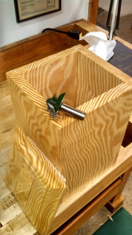

Just to throw it in the hopper as another alternative to mitered corners: I purchased a 45 deg. interlocking miter router bit as pictured on the box below. I purchased it at Woodcraft Supply several years ago, partly because it was on sale and I was intrigued by it. Finally tried it in September mounting it in my woodshaper. It worked like a dream, especially on glue-up as it eliminated making a spline, tape and slippage problems. A couple of clamps and it was good to go.
[ATTACH]23419[/ATTACH]

- IMG_20130820_091541_785.jpg (67.09 KiB) Viewed 2135 times
