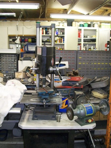

2centsworth wrote:Bill can you send a picture. Sounds exactly what I am interested in. as usual asking here is always the best solution !
Happy Holidays ! :D
This is my drilling, tapping and milling Shopsmith. I have the X/Y vise with the rotating head setting on the table. The table is a steel Total Shop table. I have short 2X4s to support the table and I raise or lower the headstock with a bottle jack to get within the ball park.
[ATTACH]23529[/ATTACH]
