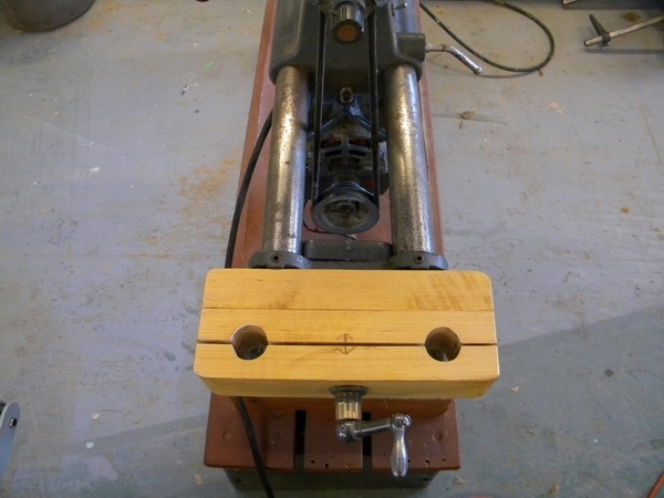

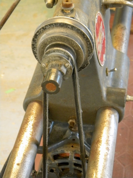

A short piece of 5/8" shaft, a 5/8" coupler(think 1/2" router chuck, but with a through 5/8" bore) and a ss drive hub.
Have you seen Shipwright's SPT adapter that came with his Canadian 10ER? It oughta work on either end.
