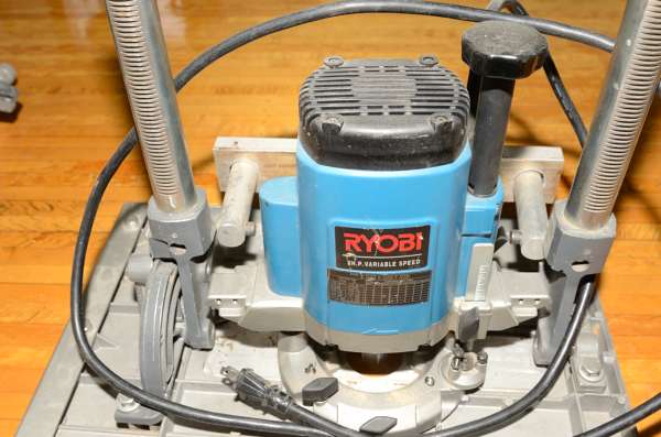

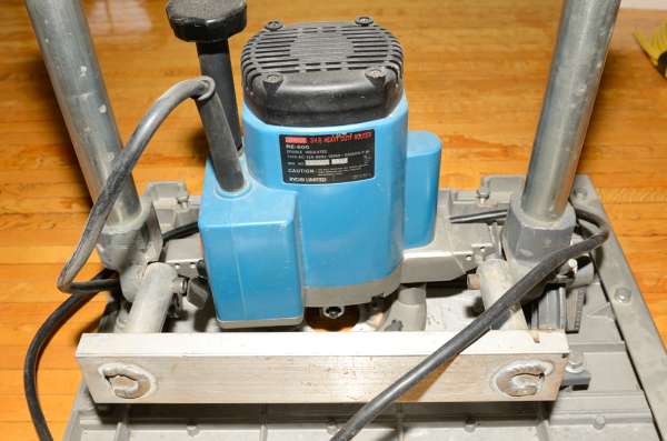

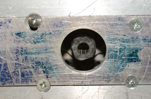

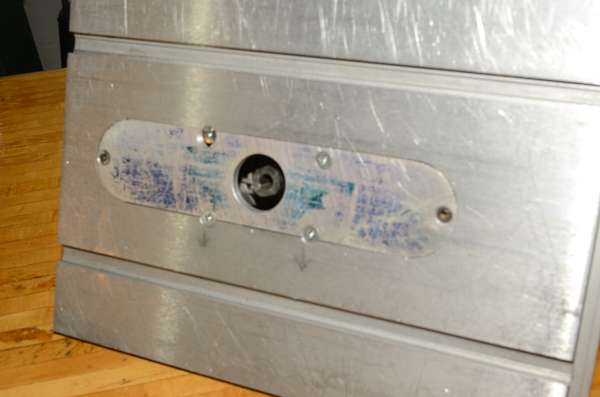

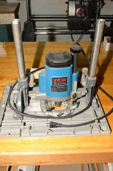

Here is my use of an old 500 table. I can use all of my fences on it.
Now if I can modify it so it fits on my new MK7, i'd be even happier...
Steve
Steve

The posts should fit!cooch366 wrote:Here is my use of an old 500 table. I can use all of my fences on it.
Steve

carrage difference
fences fit, but I was mounting it in the carrage. different widths between the 500 and the Mark 7.
Hi Steve,cooch366 wrote:Here is my use of an old 500 table. I can use all of my fences on it.
Steve
I have a 500 that I was going to part out this spring, but keep the table to make a router table. Now I think I'll use the proceeds from the parts to buy a 510 table. Had thought about grinding enough off the bottom of the table to allow the router base to set flush about 1/8" from the top. However, like everything I design in my head before I build, the final product will look nothing like the original!
Thanks for the pictures. They help with the thought process.
Be well,
Ben
