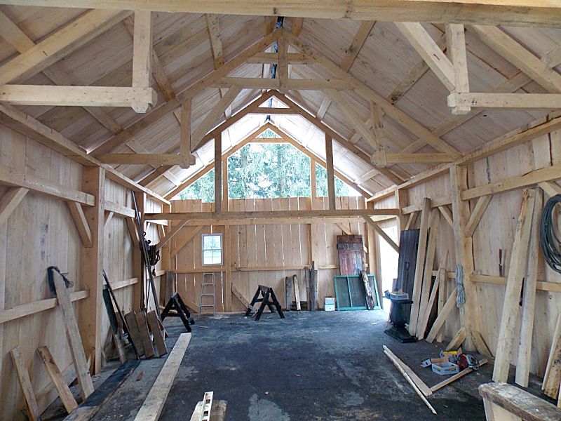

Do you have an Amish crew helping you to build your shop? I am really impressed with the open truss and the apparent dado and or mortise and tenon construction of the trusses. Looks to be very expertly done!!
Bill V
[quote="wa2crk"]Hey Paul]
I am curious re the design of the two center trusses. I am not sure how the forces are distributed by/to the descending side part. Also the upper joinery near the ridge.

No amish crew.Just me and an occasional helper.It's far from perfect but should stand forever.It's all Green hemlockexcept for an few white pine pieces.8x8 posts ,6x6 tie beams along the wall,4x6 most everywhere else.5/4 wall and roof planks.
The Hammer trusses are 4x6s.I just looked at a few pictures in books and online and put them together.I cheated and used 6" and 10" spikes on those.I did inlay hammer vertical and horizontal and the center vertical to the double cross ties though.I have to install one race yet into the one truss.The other trusses have the queen posts to help support the spanned floor tie beam.[i 'm not up on all the terminology so the pieces may have other correct names]With the 9:12 pitch I believe they are over built .to the best of my knowledge the double ties will prevent them from spreading and the Hammers will preven any sagging.Together I'mnot too worried .

Me neither on the terminology, but I do not 'see' a solution for the 'spreading' forces. Apparently the design principals are not all that well understood anyway. Methinks 'robust' timbers makes up for much!

Location: Delevan,NY
Post by paulsgreenbarn »
The trusses can't spread with the double crossties and the horizontal members making up part of the Hammer sections.The verticals and angle braces work with the horizontals to prevent both spreading and downward sagging.I'm pretty sure I got it all covered with the design.i may be wrong.I could even install angle braces underneath to the two posts but I don't think they're needed.
