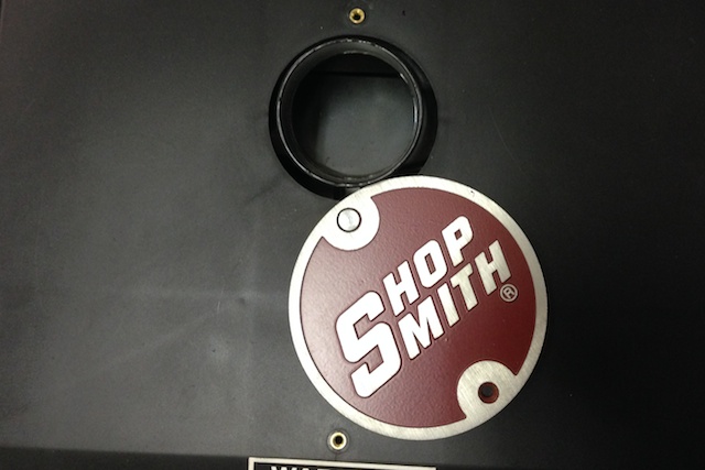

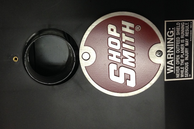

kaynyne wrote:Thanks for the pics Mike. I thought the SS name plate came off and it got connected there. I guess I was wrong. lol. So I have to pic up the cover and put the dust collector in that spot. Thanks again for the pics.
Actually, the name plate rotates out of the way with one screw removed.(I think)
Mike907
Posts: 550
Location: Anchorage, AK
Post by Mike907 »
Those pictures were with the planer cover open. The Shopsmith nameplate gets rotated 180 degrees to reveal the dust port with the cover closed.
[ATTACH]24711[/ATTACH]
[ATTACH]24712[/ATTACH]
