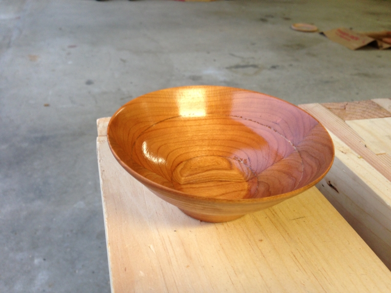

Buffing is actually a pretty simple way to get a great finish on items without the hassle and expense of excess sanding.
There a two basic "strokes" to use when buffing. Cut and Color
The "Cut Stroke" is performed by moving the object against the rotation of the wheel starting in the middle and working up. This is the more aggressive of the strokes and is used to remove abrasive scratches from the previous abrasive level.
The "Color" stroke is performed by moving the object the same direction as the rotation of the wheel start in the middle of the wheel and move toward the bottom.
Always have a firm grip on what you are buffing. Those strings/material can grab and fling objects easily.
There are literally dozens of compounds available. For general buffing I use three compounds, Tripoli, Whit Diamond, and a plastic compound (color varies n these). I also have a green metal compound (I use this for stropping edged tools) a Black Metal Compound for light rust removal and initial metal buffing.
Helpful hint. Only use one compound per wheel. wheels are relatively expensive and cleaning the previous compound is a real hassle.
What I typically do for highly finished items
Develop a thick layer of finish on the project to be buffed (sanding between coats/layers etc.)
Final sanding to around 400 or so (sometimes higher sometimes only lower depends on the project). Leave a uniform scratch pattern creating an even haze on the finish.
First wheel I use has Tripoli using a "cut stroke" the goal is to remove the sanding scratches from the sanding. The haze disappears and the finish has a more matte look to it. If you want a matte finish stop here.
When finished removing the haze, use a "color" stroke, this brings up the level of the shine (say semi gloss)
Next wheel is the White diamond.
Cut strokes to remove the scratches from the Tripoli and bring up the gloss.
Color Strokes make it shinier and prepare for the polishing on the next step.
Last wheel plastic polishing compound. (I also have a wheel for wax. Sometimes I'll use wax instead of the Plastic compound. Again it all depends on the project.) For polishing, use a color stoke only. Really no need for the cut stroke and the aggressiveness just strips the polish away.
This is an example of the end result.
Cherry bowl from a board with 3 coats of rattle can gloss lacquer, dry sanded to 400 on the lathe.
Buffing regimen as described above.
Tripoli (cut and color)
WD (cut and color)
Blue plastic polish (color)
[ATTACH]24834[/ATTACH]
I really wish I had done a better job on the glue up of this bowl. It really shows with this high of a finish. This is the down side to a great finish. Every flaw in workmanship is magnified.
Good luck with it. I think buffing is the best method (Both speed and cost) for achieving highly polished finishes on smaller objects.
