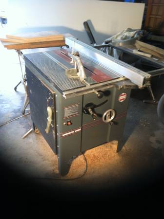

For anyone in the Ohio area that is interested, here's a clean-looking Sawsmith 2000 listed for $350 on Craigslist. I don't know much about them, but believe this one has the high-end fence option and extension table(s). Pay no attention to the lawnmower in the same ad!
[ATTACH]24962[/ATTACH]

BuckeyeDennis wrote:Very interesting, Heath. Do you have a feel for why these types of machine didn't catch on?
I really looked hard at the Sawsmith 2000. I wanted to buy one in so badly.
However of the two I saw both had over .005 plus and minus blade slop moment side to side.
In fact the movement was so that you could not only feel it you could actually see the blade move is you put pressure on it from the side.
The problem was the carriage was poorly constructed and just would not hold the blade in one position.
Second problem every one complains about Radial Arm being dangerous moving the blade. However on the radial arm you could see the blade on the Sawsmith the blade could be hidden moving toward you before it cut through the wood.
third problem it was priced like a Powermatic or a Unisaw and it didn't have the stuff to compete.
Ed in Tampa
Stay out of trouble!
