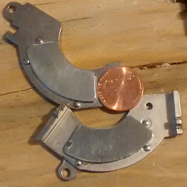

A good potential source of quite strong magnets is old hard drives. They each have two very strong magnets:
[ATTACH]24991[/ATTACH]
They are the arc shaped parts, glued to the larger backing. About half seem to break when pried off.
Hope this is more helpful than off topic.
