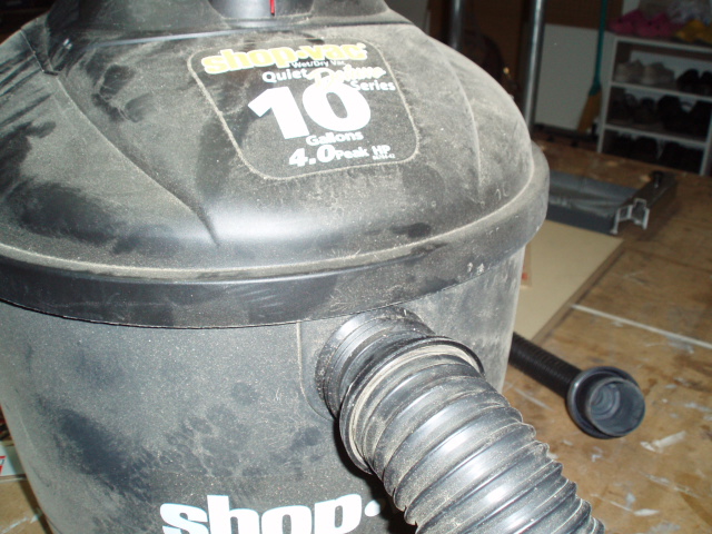

My Shopvac has a 1 1/4" hose also but the port on the vacuum itself is 2 1/2" and fits onto the the DC3300 hose. Do different Shopvacs utilize different connection methods?
The hose laying off to the right of the Shopvac is the Shopvac hose.
[ATTACH]1493[/ATTACH]
