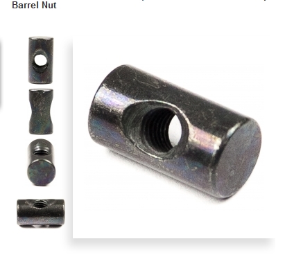

Please elaborate JPG. What I am doing is where the vertical legs attach to the horizontal rails drilling cross grain in the legs, then into the rails, then a access hole cross grain in the rail for nut access, rails and legs are M&T jointed also, designed to break down bench in modular fashion to take apart for moving. Trestle style ends, connecting rails, and top.

Got it JPG, the barrel nuts, I have used them in a rocking crib I made so could be broke down when infant no longer fits. I am using 1/2" bolts, I dont think they make them that big, but would have worked if so. If I hit the holes dead on.

Made to order fer your application. The barrel is sized to the cross hole. Provides greater surface bearing area without tending to split the wood. Not easy to find. Fairly easy to make.

Pipe would work!:Drbursek wrote:Got it JPG, the barrel nuts, I have used them in a rocking crib I made so could be broke down when infant no longer fits. I am using 1/2" bolts, I dont think they make them that big, but would have worked if so. If I hit the holes dead on.

Pipe like in galvanized plumbing pipe? How to cross connect, with a T fitting?
Easy to make only if you have what it takes to make!!! Ya that would have been the cats meow. In small size and shorter connecting bolts they are very common to find around here, max I have seen is 1/4" bolts at about 2 - 3" lengths.

Cut pipe to width of whatever the 1 1/2" holes are in. Drill and tap into(through) the pipe. If going through the pipe, drill the 9/16" hole past the opposite side to provide clearance for the 1/2" screw.rbursek wrote:Pipe like in galvanized plumbing pipe? How to cross connect, with a T fitting?

Screw through leg and into rail? If unclear, I will doodle a pix.

Got it, thanks!!!! I will modify.
