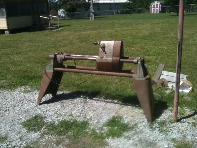

The rest haven't seen the machine picture you posted on LJs. You have a 500....I think. The 510 was an upgrade of table size and accessory table size.

If I understand the link Dusty provided, our green SS is indeed a 500.
Thanks for the link, Dusty. Gene, Good idea. Will start a post after we have a better idea of what all we need. In the mean time...
[ATTACH]25352[/ATTACH]

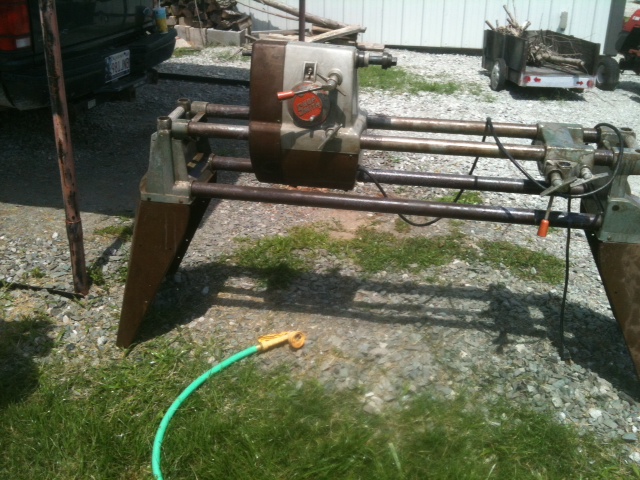

[ATTACH]25353[/ATTACH]

First, welcome to this forum.
Please overlook the second post to this thread. No harm intended.
Now, it be not easy to tell from the pix, but it appears to be an "A" headstock casting which is consistent with it being a 'Greenie' and most likely is a Gilmer drive belt version. I say 'likely' since it is possible to update. The belt cover looks like it may be a later version(only two retaining screws?) and maybe from a Goldie.
Glad to see the tables etc. in the second pix.
The motor pan appears to be a Goldie also but the pix may be showing rust rather than gold paint.
After cleaning it up, lubrication is advised. These beasts run forever when properly oiled(often) and maintained.

P.S. It is a Mark 5 which predates the Mark V/500/505/510/520. There are other variations.
